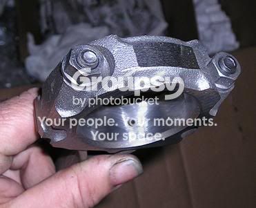

Then I got out the first rod. I haven't opened them all yet but here's what they look like now.
A little off the top...
And a little off the bottom...
