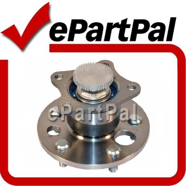

I have a 91 camry DX nothing special FWD auto.
I have 240,000 miles on the wheel bearing, and even though I have no noise coming from the wheel bearings, I'm guessing they need to be replaced. They are the org. wheel bearings, as I've owned the car since new.
Can I replace the rear bearing, spindle, and hub with a 92-94 bearing hub combo with the ABS ring even though my car didn't have ABS. in short is there room for the ring to fit in the housing the hub attaches to? If not, is there away to pull the ring off, and will it fit then? I ask because it appears they don't make a spindle, bearing, and hub all in one unit for my car. I would like to just pull it off and bolt a new one on with out of having to press the spindle out, then press it back into a new bearing hub.

I don't believe the upper attachment points (to the strut) are compatible with the gen3 Camry hub. It should be cheaper to get the parts pressed on anyway (just take the parts off and have it done at a machine shop).

Can I put one of these in? Link to pic below. It's for a 92 with ABS.
http://images.channeladvisor.com/Sel.../eHUB_H016.JPG
