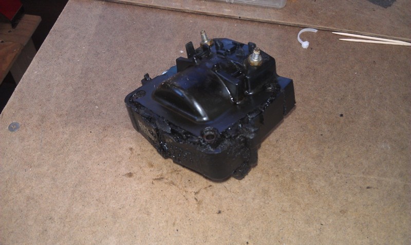

Took my distributor off today. The coil looks pretty rough, quite a few cracks. The coil was also dripping oil.
I recall when I changed out the distributor cap that the lower screws were a little loose. I wonder if these being loose allowed for oil to leak out and not build up around the coil? When I put the new cap on, I made sure everything was good and tight, and just a few days later the thing was dying on me. Perhaps with the new cap, the oil accumulated and got into the cracked coil?
Anyways...now I need to decide how to fix this. The cheapest way would be to replace the coil and to buy a seal kit and rebuild the dist myself. I can buy a rebuild from the local places for around $150. The rebuild would be the easy way out though.
With 215k miles on this distributor, is it worth fixing and continuing to use? Or would I be better off buying a new or reman unit from a parts store? I really just don't want the damn car leaving me sitting on the side of the interstate again!

I R&R my top end seals last spring, inspected my distributor for wear, was in good shape so I R&R the O-ring and installed.
Car just crossed 304,500 miles on the way to 500,000 (my objective).
Toyota distributors seem to take allot of use/abuse. If you can find worn parts in your's I would R&R them. But I not would be afraid to continue to use the same distributor once you have found your oil leak.
Hint:
Play close attention to the end of the valve cover, above the distributor, where the cam shaft notch is located. The seal after returning to the flat part of the head can at times be very tuff to stop oil seepage / leaking.
As for the coil in your pic, if it tests bad, I myself would get one from the local salvage yard (why else would anyone own "an old Toyota", if you wernt planing on salvaging parts).......... Save the new parts for the new Toyota's

I went ahead and purchased a rebuilt distributor and installed it today. I drive a fair amount of miles every day with this car, and with it being out of commission I have been forced to drive my truck, which gets roughly half the MPG that the Camry does. So getting the car back into service faster will save me fuel costs (around $50 a week to drive the car versus $100 or more for the truck!).
The reman Dist was by Cardone. Once setting the ignition timing, the car is running great, if not better than it was before. Hopefully this was the problem that caused it to die in the first place. I test drove it a fair amount of miles tonight and didn't have any problems. The old coil actually had oil inside of it when I took it apart! Not sure if it was around the windings or not, and I did not test it with my DMM before getting rid of it.
