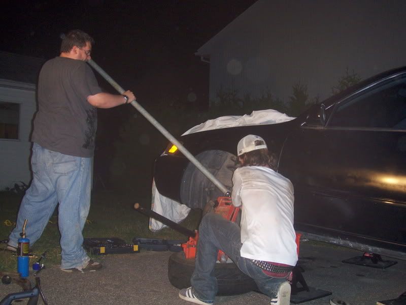

A friend came over tonight to help me out with this, we used the jack as a support to get better leverage. I was pulling on the breaker bar to hold it on the jack while he was pulling the fence post down. It got it moving about a quarter on first try so we gave it another go and the head snapped off. I could now at least remove the old control arm to see the exposed part of the bolt so I lubed it up some more and snapped a vise grip on it. And it apparently stripped because I could turn it well but it wasn't coming out. I can now litterally wiggle the bolt with my fingers but it doesn't have a head anymore, and it's stripped. Or the engine cradle threads are stripped.

Man! what a b$tch that is! I hate when that kind of thing happens, and them you find yourself in deep sh$t. I wonder if a weld behind the bolt has broken off now because the bolt was totally seized in it? I'm assuming that maybe some sort of thread insert was welded to the cradle inside. That would explain how you can wiggle it. If you were able to shear the bolt head off of that, then it is definitely seized. That's a lot of torque for a bolt that size. Is there some sort of inspection hole underneath that you can at least use a small mirror with to inspect behind the bolt? Can you use a punch and a sledge hammer to try to punch the headless bolt back into the cradle frame? I don't know how else you can fix this except to replace the cradle, or have it repaired by having a hole drilled underneath for access to allow a new nut or thread insert welded back on and then the hole patched to return the structural integrity to the cradle frame?
It will be interwsting to see how this one gets solved. I wish you luck.
I just saw another suggestion for a similar problem to yours. If the interior nut weld is truly broken and you are able to punch the existing broken bolt out, another option is to find a long bolt of the same diameter and strength, and drill straight thru the cradle beam to the other side and slap a nut or two on there and torque it down. This is probably going to be your easiest solution besides breaking out a welder and doing major structural surgery. I think what I would personally do is to drill a hole underneath the cradle beam just big enough to insert a new nut into the back of the existing bolt hole with a lock washer. Drill the hole just big enough to slip the nut thru and no more. Epoxy the nut to a stiff piece of wire or something that you can use to guide it in maybe. THis will weaken the cradle beam a bit, but probably not a lot. If you are still concerned about it, you can always take the car in to someone later to get a small patch welded over it.

dayum, that's a long ass breaker bar
at any rate, i wish you all of luck in getting this fixed!
