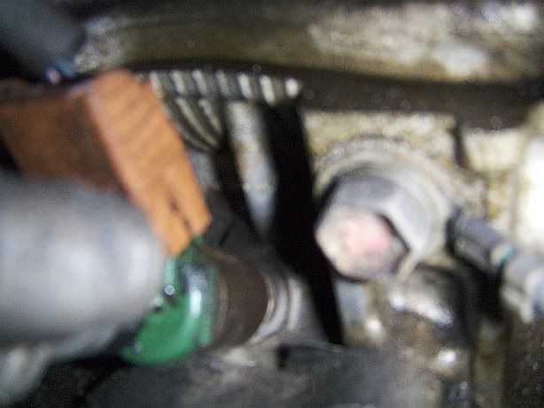

Went back to take another look, it's definitely the injector, I have no idea if the thing is cracked or if it's just a O-ring on it that crapped out. The engine is running fine so I'm assuming if the injector was cracked it would've been running pretty badly but it's not.
Here's a picture of the offending injector, injecting a little bit of misery in an otherwise pleasant day :

Thanks a lot, basically the fuel rail will just lift right up the head after the bolts are loose?

Originally Posted by JJJJJJ View Post
Just try replacing the gasket with a new one first. If that doesn't work you might get lucky and find a used injector.
To relieve pressure, undo the gas cap and let vent.
Disconnect the inlet and outlet banjo bolts at fuel filter using a flare wrench (if you use anything else you risk damaging the fuel lines) to reduce pressure to rail.
Seeing as you replaced the O2 sensor, you should be able to handle this quite easily.
Needless to say keep a fire extinguisher, gloves, and a water source nearby.
Also wear eye protection and keep the duMauriers away.
By the way, did you ever recover your cash for the exhaust pipe you ordered ?
Venting the gas cap will not bleed fuel line pressure. Depress the schrader valve on the fuel rail. If yours does not have one, just put a rag under the injector and pluck it out of the rail. Lube the new o-rings to avoid cutting them on re-assembly.

Well, did the job, fairly easily. The injector seat looked all scraped up so I bought the seat and changed it. All smelled well on the first test drive but then I got home and realized I had nothing to eat so I drive to the convenience store, come back, lift the hood out of sheer curiosity : Fuel smell, the same injector seemed to be at fault again, left it at the dealer.
They are open until 2 AM wich is good so they might have time to look at it and call me back tonight wich is awesome.
EDIT : I didn't re-install the new seat properly and it got somehow squashed. Oh well all is good now. I hate working when it gets dark but I was a bit short on time, didn't take any pictures for that same reason...
