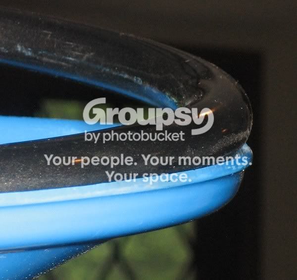

I'm putting (or trying to, anyway) a set of Eibach Pro-Kit springs on my '94 Camry with Tokico Blues. The back springs and strut installed OK. But in front, the spring doesn't fit into the lower spring perch on the strut like it should. When the end of the spring is seated in the perch, the other side overhangs the strut. It should fit inside the perch all the way around.
The stock springs are a few mm less in diameter, and the Toyota OE struts and Tokico struts seem like they're the same size. Looks to me like the problem is an oversized spring. Eibach tells me that they measured another spring and that they all measure about the same as mine (191mm). The Toyota OE spring and H&R OE Sports are closer to 186mm. Has anyone else run into this? What did you do?
The car looks pretty funny right now since it's going uphill with the lowered rear. If anyone has a set of springs laying around in the garage and would be willing to measure them and post the result, it'd be a big help to confirm that it's not just an odd spring or two.

Hmm... I had both the mechanic working on my car - a guy that does this stuff for a living - and a Tokico engineer tell me that the overhang wasn't right. That made me pretty nervous about just putting them in. I'm still on the fence thinking about just canning the Eibachs and getting H&R's and starting over on the rear.

litterally hundreds of others have had the same setup and never had issues. maby they never noticed. and maby that has contributed to the "clunky" gen3 suspension issue. but ive never seen any problems to date like this.

^ This might shed some light as to the clunking issue. I am going to check my H&R and KYB combo and take pics of it tonight and show you guys if I have any over hang.
OP wait for my pics before canning the eibach setup.

Thanks for the pics. Looks like the H&Rs fit perfectly. If I can't sort this out with another call to Eibach, guess I'll have to order a set of H&R's and start over again.

It's fine, as long as the end of the spring touches the "lip", you're good.
The spring will seat itself once you get it on and lower the car.

Had the Eibach's in for a week and had the overhang. This caused the clunking for me in the front. Replaced them with H&R. I still have the Eibach which were on my car for a week if anyone wants to buy them for dirt cheap.

Did you leave the lower insulator (the rubber ring that goes on the bottom) out of the pic for illustrative purposes?
If not that could be a source of clunking.

thegmann, the picture was taken with the spring and strut off the car. After putting the strut and spring together and finding the overlap, we didn't bother to put them in the car.

I repeat, the spring will seat itself once you have it mounted and lower the car back down. The weight of the car will seat it...
