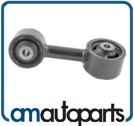

RPM's, Tachometer (Revolutions Per Minute).
Also, check the Passenger Side upper motor mount. See if the rubber is broken/ripped/torn. This mount being bad can often cause a vibration.
