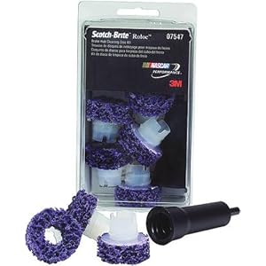

Originally Posted by fenixus View Post
SexieWASD, what do you use for honing the slide pin guides (the bracket slide pin holes right?) ?
I assume you leave the rubber boots in place or you replace them too?
Yea The holes, They make hones for them, but my Snapon dealer showed me a trick (He used to work at a Toyota dealer as a tech) Just take a piece of mechanics wire (coat hanger would work) and bend the tip over to make a hook, slide some 1" emery cloth in it and turn it until it wraps up to where it's just a bit loose in the hole, stick it in a drill and give it a few passes. It works better than the hones because you always have a fresh one, and with the hones you have to buy a set because if the different size slide pins.
We reuse the boots unless they are ripped, or otherwise ruined, but I do coat them with high temp brake grease (just enough to make them shinny) which keeps them from dry rotting.
In the end we end up using all this stuff to get the job done.

thanks!
this gives me some ideas about unjamming the top slide pins (tried a few times and still is no perfect).
