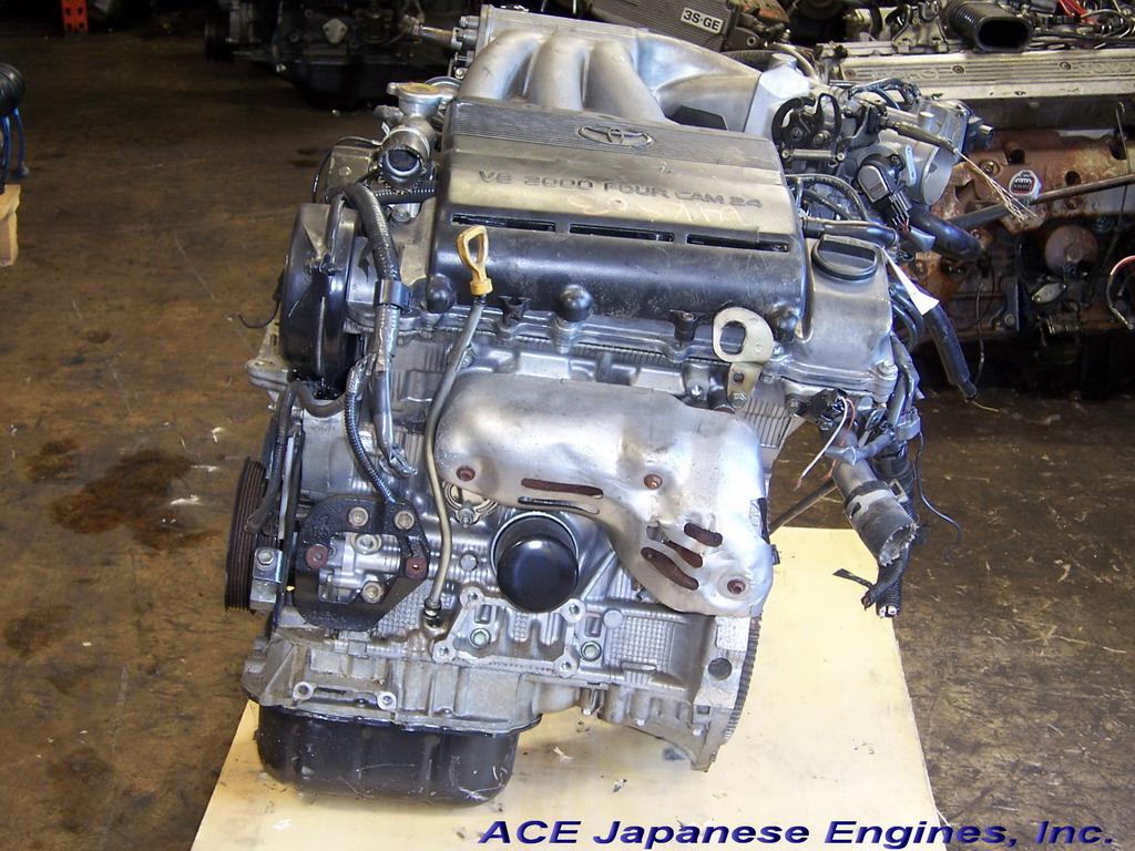

Image from the internet...
Going by that piccie...maybe behind the front motor mount?

Going by this internet image...most likely underneath the front motor mount...

Ah I see what you mean. Comparing the photos there's a good sized pocket behind the engine mount. It looks like it's fairly well sealed by the mount, but maybe the fit between the mount and block is not that tight. I'll have a closer look there. Thanks for the pics. Looks like a good candidate.
