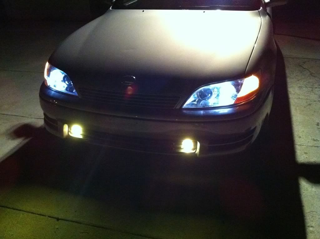

I just Bought a set of Nokya Artic Whites for my Corolla (Same H4 bulb) and i dunno what bulbs i had in my headlights before but my light output is much better and the light on the road has doubled. they operate at 7K on the kelvin scale and look pure white with a hint of blue.
I also have them in my ES300 too (They arent this blue. My phone just picks it up this way)
This is more realistic.
