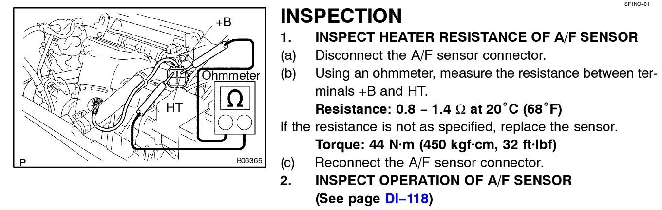

P1135 = A/F Sensor Heater Circuit Malfunction (Bank 1 Sensor 1)
Bank 1 Sensor 1 = front sensor, in exhaust manifold.
Heater can be checked for resistance:
"Skoolin' the unlearned!"
