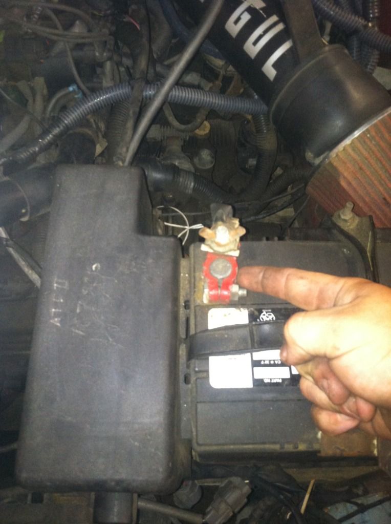

Next, Disconnect the battery and wait at least 90 seconds. This is a very important step

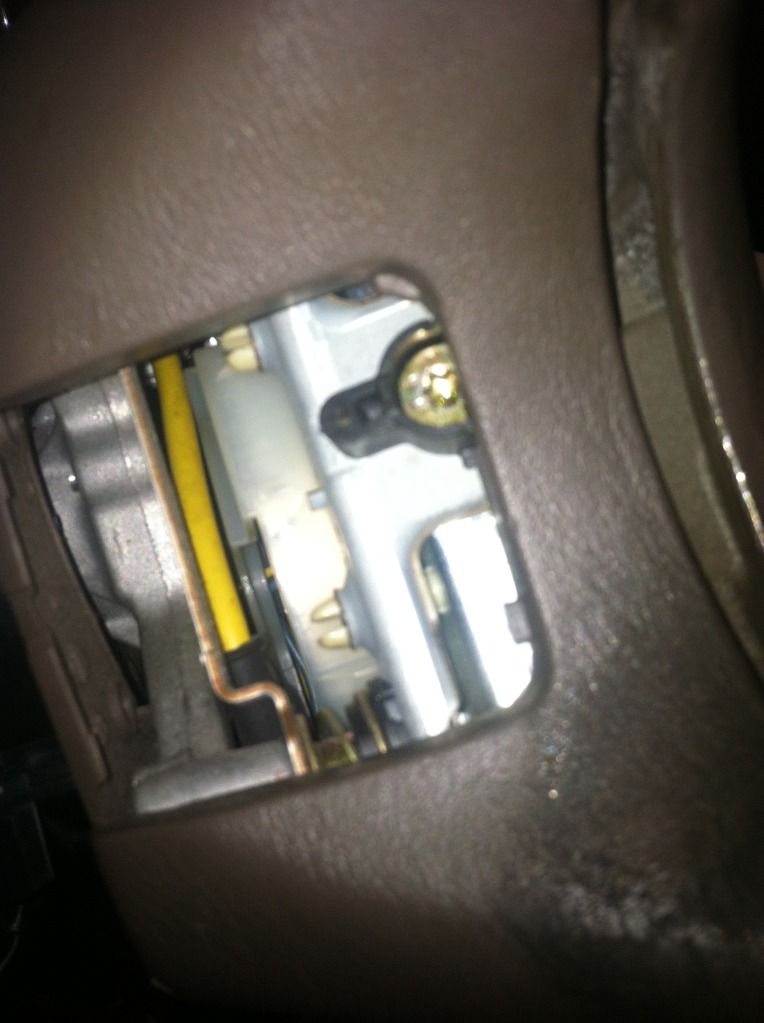

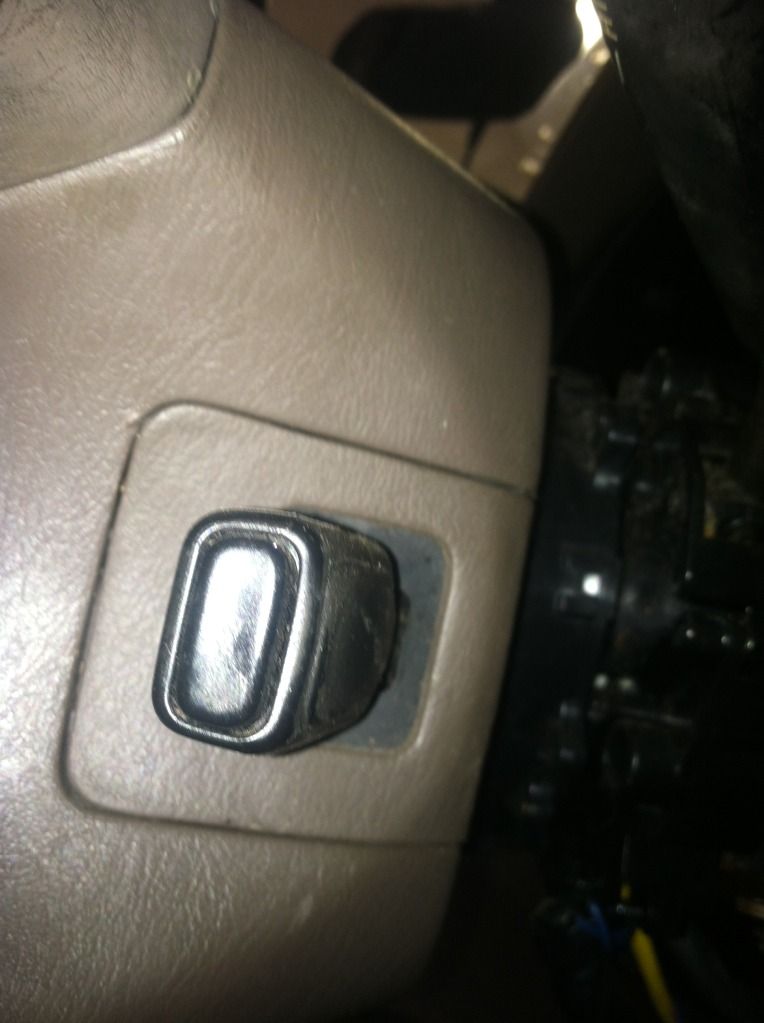

Next, remove the side covers on the steering wheel with your small flat head screw driver

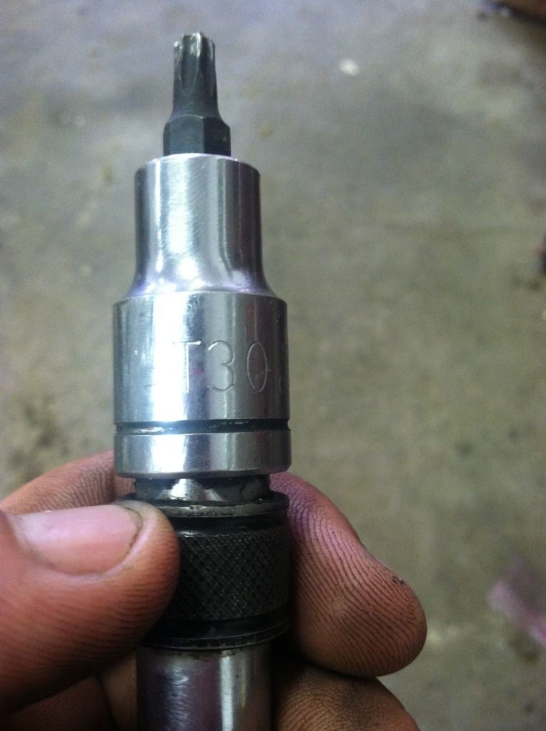

With the cover removed, using your T30 torx remove the bolts holding the air bag onto the steering wheel

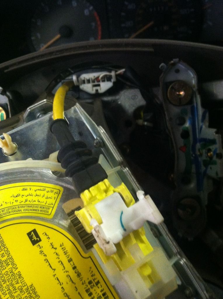

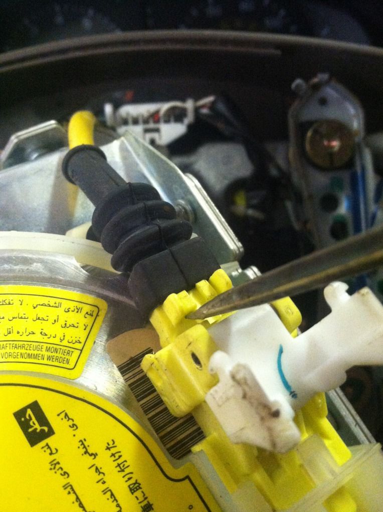

With the T30 screws removed, next step is to remove the airbag and airbag wiring harness. The airbag wiring harness has an involved clipping system that will require your small screw driver

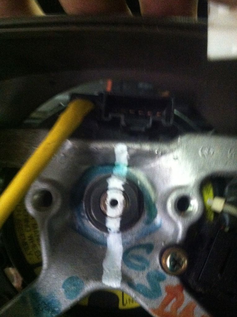

Next, with the airbg safely removed mark off, since your wheel is already straight, with a paint marker, mark off direction lines for re-assembly

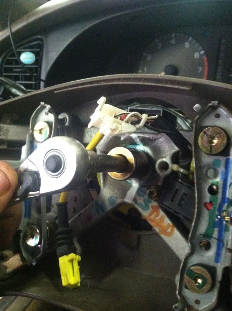

Remove the 19mm nut, and horn wiring plug that is attached at the top of the horn area (white plug)
Firmly grip each side of the steering wheel and pull and twist until it pops off (requires some brute force sometimes)

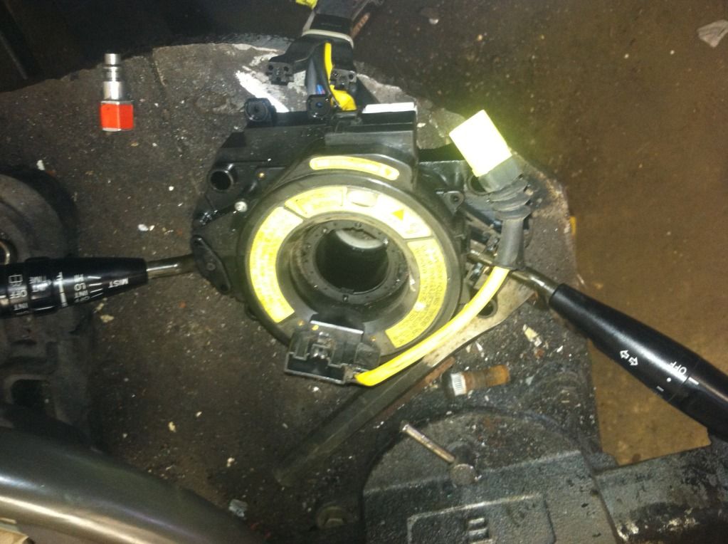

With the steering wheel removed, there are 4 phillips head screws that hold the SRS ring in place, remove these and hang the ring down. After the 4 SRS screws are replaced, there is 4 more that hold the turn / wiper switch in place. let that hang as well.

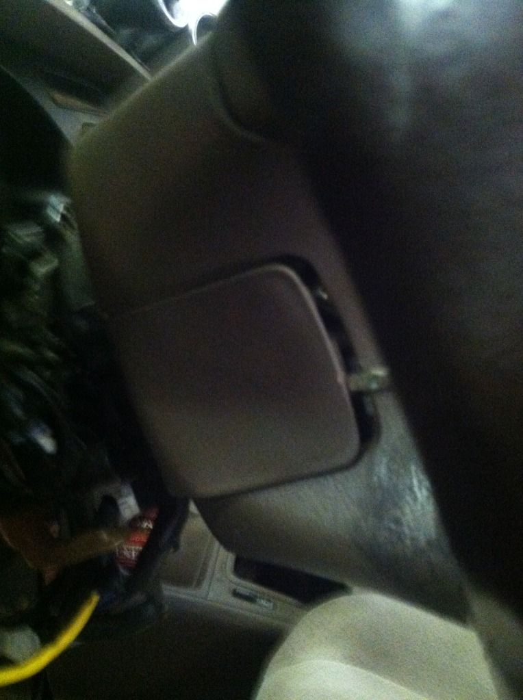

Next, remove the four 10mm bolts that hold the bottom Knee Bolster in place (the cover that is under the steering column) You will need a flat head screw driver to remove two of the covers to gain access to the bolts.
With the 4 bolts removed, remove the cover and follow the wiring harness from the wiper / turn switches to where they go (Attached at under the column). Remove the harness plugs and swap your new switch in.
