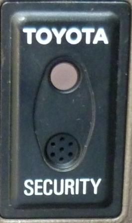

Either RS3000 or the RS3200 had a 'SECURITY' light next to the rhetostat in the Camry.

Locate the piezo buzzer. Again, I'm getting conflicting information on this. I've found supposedly 'dealer' installed RS3200 without this piezo by the master cylinder, but they are located on the passenger front side marker. I'm suspecting maybe it could be a dealer 'factory' install will have the piezo buzzer on the brake cylinder. LE models that don't come it the keyless might be pre-wired for the piezo by the front passegner marker? Not sure. As far as I know, if it was a true dealer install RS3200, the piezo buzzer is included like shown below.
