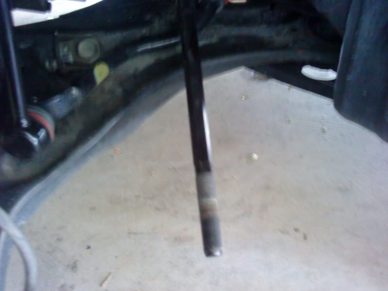

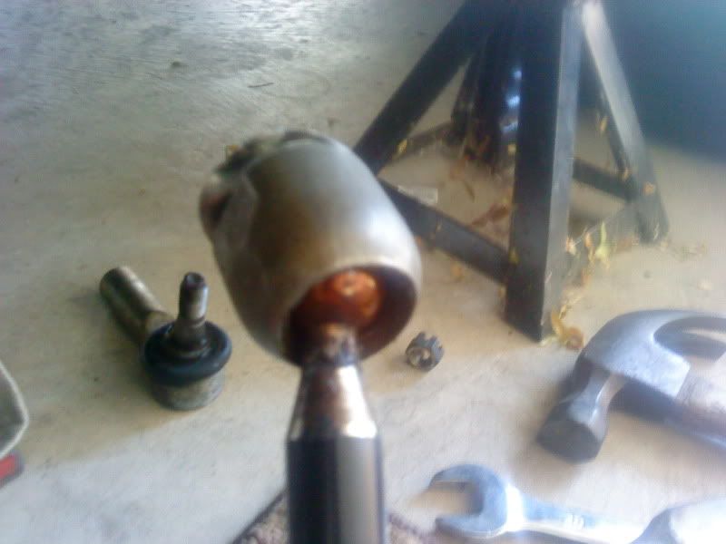

success, i had ordered inner tie rod from rock auto but it won't be here till friday, when i loosened the castle nut i noticed grease under the rubber boot on the tie rod end, i went to advance and got a moog inner tie rod as well as the tool (which helped me so i could torque it to spec. i went and got the moog tie rod end and well it was shot too
original inner tie rod and lock washer that i had to deface to bend the taps back LOL
i need to get an alignment today since my steering wheel sits facing 9 o clock when going straight and pulls hard right if i try and straighten the wheel :P
