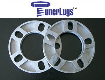

i got the IS 350 rims 18 x 8.0 and 18 x 8.5 and the rears are 1 mm from the shocks i wanted some advice form you guys on what to do.
I was thinking about getting a spacer but a lil unsure what size of a spacer maybe a 5 mm, 10 mm, or 15 mm I NEED HELP GUYS THANKS

You don't want to go much over 5 mm on a spacer lest the lug bolts' effective length will be too short.
+1
If you want to go more than 5mm then you should get the wheel adapter.
Wheels spacers
Wheel adapters
