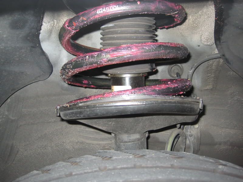

i think my driver side strut is blown or somthing, it make a werid noise and the rubber thingy is stuck, i have pics of it, also the red/pinky thingy on the spring is grease, before my spring make lots of noise but aftter super greasing it the noise wear down and stop.
right side strut
driver side
