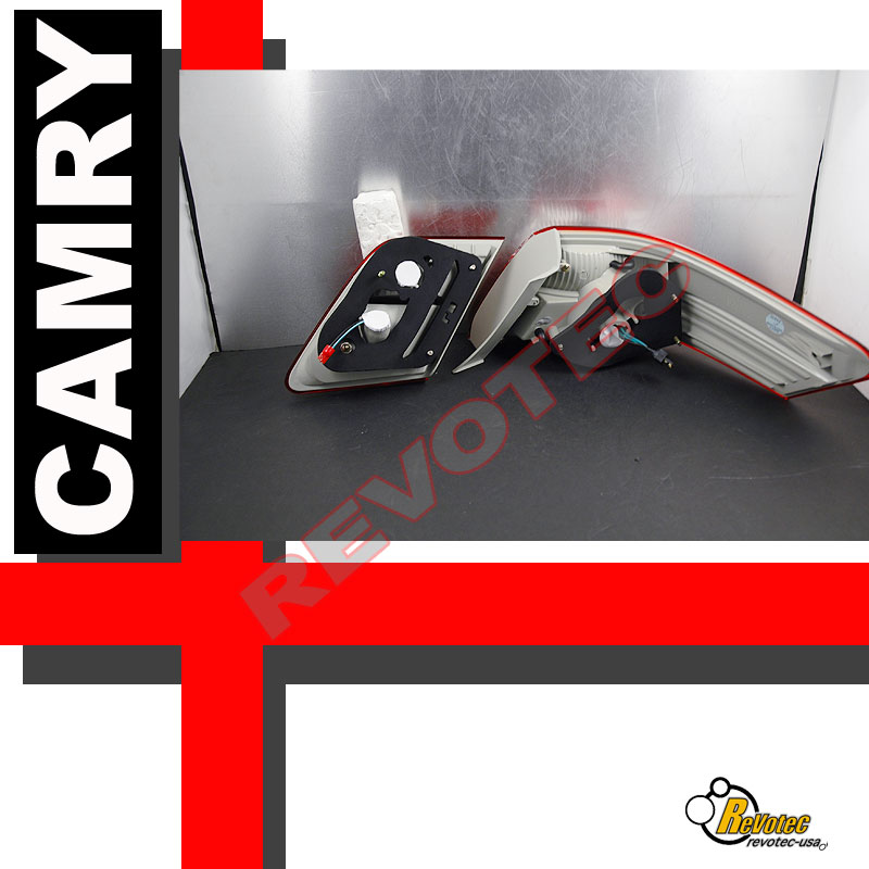

Hey everyone, I have a 2007 Camry SE, and I've purchased these taillights:
http://cgi.ebay.com/ebaymotors/ws/eB...3AIT&viewitem=
CONNECTOR PICTURE HERE: http://www.revotec-usa.com/product/t...7LED-RC-01.jpg
On the right(The big light) it has that blue black wired connector that should plug right into where the original bulb was..but I wonder, what if I plug it in wrong? will anything happen? what do I do? how can I know how to plug it in right, without using any tools..since on the ebay page it says its all plug and play but really no manual for this.
Please help me, as I am working on removing the tail lights right now, as I type.
Thanks!!

If they don't work, unplug and reverse. LED's only work with one polarity. By the way, how are you going to "plug and play" the lights onto the car without tools???

Without a real closeup of the connector I can not give you a definitive response, but nearly all connectors of this sort are idiot proof and can't be connected backwards. If you are so unsure of yourself then find someone with some basic electrical knowledge, and I mean >basic<. The led's will only work if the dc flow is correct so it should be fine. Just don't short a positive directly to ground and things should be good. Use your volt/ohm meter. Don't have one? Don't know how to use one? Get some outside help and learn how to do the job.

..+1 what GeorgiaHybrid said. Just plug it into the same connector, which was plugged into the outer section of the stock light. Make sure you test the brake lights as well before snapping the new lights in place! If it does not work, flip the connector around, nothing can be damaged connecting LED's with 12V in the wrong polarity.

Alright, thanks guys, I guess I will just play with the connectors and see which ones work, and um there is no idiot proof lol cause it fits both ways..thats the interesting part since the bulb that plugs into the socket has same connectors on both sides, same thing with this connector.. so basically if I play around with it nothing will damage? the light itself, not any fuses? thanks

A regular bulb does not care about the polarity. You can reverse the positive and negative and they will still work. LED's will only work one way. You will not harm them, they will just not burn. Reverse the plug and they will be OK.
