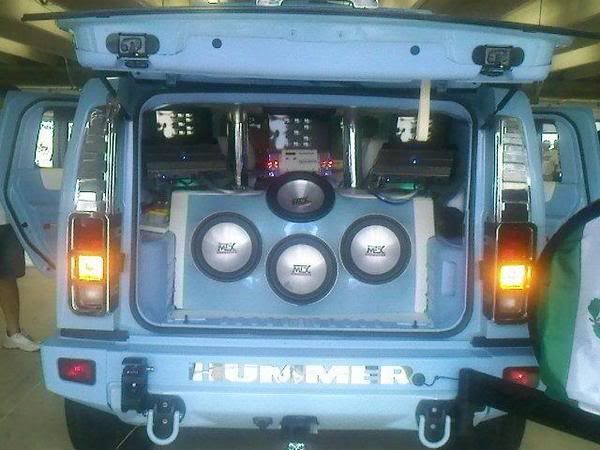

Here are some pics of some toyotas at the last ATL Motorsports Nationals which was televised on 2 channels. Me and my club have really made a name for ourselves here in the south. We have been the first club to sweep at this auto show with 11 of 11 trophies. I will show other cars as well. Enjoy.
