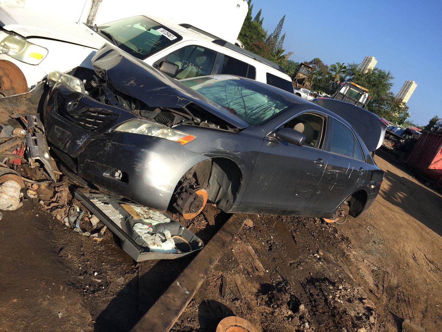

I'm almost 100% sure I found the issue.
Yesterday I had to go downtown for a social meetup. Car was shuddering and missing terrible for over 20 minutes only under engine load. Idle felt OK. So it came back...
I went to the junkyard today. Pictures are posted in the Gen3/4 forums.
Found a Gen6 2AZFE engine Camry. Thought the coils would be a good test subject for my issue
So I didn't know, but there is a difference between the 2002-2006 Camry coils and the 2007-2009 in the 2AZ. This coil part number (90919-A2001)
http://www.toyodiy.com/parts/xref?s=90919-a2001&mU=on
The coil from the 2007, 2008, 2009 Camry 90919-A2001 is a hair longer than the one in my 2004 Camry 2AZFE engine. I assume the other years 2002, 2003, 2005, 2006 uses the same size. It will work though, but won't sit flush as it is a TAD longer. The one from the newer 2AZFE engine is on the right. Wonder if this was to combat a known issue with the earlier 2AZ? Hmm....
I installed the new test coil on Cylinder 4 since I've swap the suspected bad coil that was originally on 3 to cylinder 4 as I had a P0303 ONCE this week and it never came back even with all this misfiring and shuttering going on. I was initially hoping the suspected bad coil would trigger a P0304, but again, it never did.
Anyhow, installed the new test coil on Cylinder 4 it and immedently it ran better cold start. Idle went up to 3K and drop down to the normal 1.8K cold ish range. Felt smoother. I then threw it in gear and went up hill. Noticed the car had more pep going up hill and less shuttering while accelerating. Went to lug the engine on cold in 3rd/4th gear going 25mph. No shuttering and it felt like the car had more power to pick up speed while lugging the engine. Took the car down to Costco to fill up gas. Throughout the freeway drive, the car had more pep throughout the RPM band but very noticable on the lower end. Car also didn't idle as rough, I thought it was just a 2AZFE 4 cylinder thing.
BUT it could had been a placebo effect in my mind. Sooooo I swap the old suspected bad coil back into Cylinder 4 at Costco while the engine was at normal operating temperature. No shame.
Swapped the coil with the old one, went to start the car. The car started fine but as it started to idle, it stumbled and idle dipped erratically then idle evened out, dipped, shuttered. Car also had a familiar 'shake' when it did (or thought it did) idle 'normal'.
Put back my other 'test' coil, smooth as butter.
