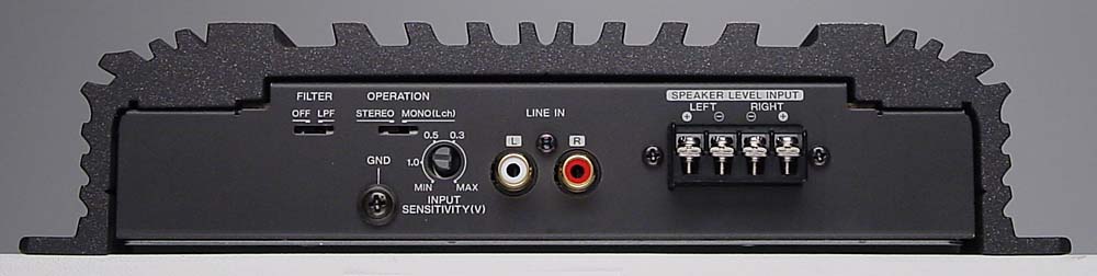

how exactly do i wire the 2 channel amp to the subs, bridged, parallel, series? Any tips on installing subs into a box? is it as simple as 4 screws?(sealed)

Here....this is a side view of that exact amp (found it on Crutchfield's site)
Notice that there is a Right and Left channel &quot;+&quot; &amp; &quot;-&quot; speaker outputs...with these speakers being single-voice coil....all you have to do is run speaker wire from the left pos. and neg. on the amp to the pos. and neg. connections of one speaker...and the same with the other. Very simple. Box wise....even with sealed boxes it's a bit more complicated than just building a box and using four screws. Read the documentation that came with the subs and check out what the factory recomended for internal volume for the enclosure...and try to build one that meets those requirements. Also, the enclosure has to be sealed completely....which means lots of screws and the use of a sealent (use silicone)...lastly use .5 inch to .75 inch MDF(medium density fiber) wood...most say this is the best stuff for speaker boxes. Hope that helps!
