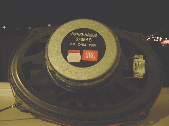

I have some old pics I took for someone a while back...
Stock in-dash tweet:
The in-dash tweeters are 4" from mounting hole to mounting hole. You're going to have a hard time finding anything decent to fit in there, though...

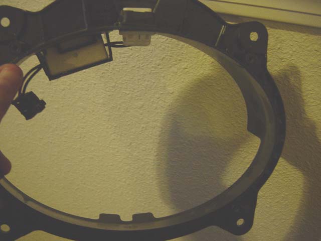

Stock front-door 6x9:
You can definitely replace these, you just need to take the whole mounting ring off and then remove the speaker.

I just bought polk audio ex369 6x9 for the back, and infinity 6000cs 6 1/2 components for the front. Does anyone know how to fit the components for the front?

i made a custom mount. i have boston acoustic rc620's all the way around. what i did was cut out the speaker itself, and used the plastic trim from the stock speaker. i used a 2 inch peice of metal and used that to brace the tweeter.

Hey homie can you provide some pictures on how you did it? Cause im confused how to make a 6 1/2 fit where a stock 6x9 went.

Trace out the 6x9 bracket onto a piece of MDF(3/4" or 1" depending on depth of speaker)cut it out ,then cut out hole for the 6.5 driver.Before installing the whole unit back on the door,get some baffles to keep water off the driver(either plastic or foam)stick them in the hole then screw down ur driver to the MDF.Also u might want to put some sounddeadening on the back side of the new MDF baffle,this is to prevent water damage to the MDF itself.
