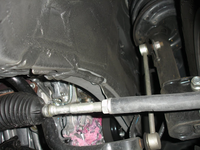

I'm new to this forum and I had a somewhat concerning issue with my 09 Highlander Limited (2x4). I took the car in for a minor service to the local Toyota Dealership this weekend. Today (Monday) I noticed some red fluid leaking which I thought could be coolant or transmission oil. I looked under the car right now and I think its coolant. It looks like its leaking from the engine somewhere.
I am attempting to post some links to some pictures and I hope they work. I'll try to edit this post until I can get it to work.
This is the first thing I noticed when looking underneath. Some fluid leaking through these panels under the right front side of the Highlander.
From the same point of view, I then noticed some dried up coolant from the side of the engine.

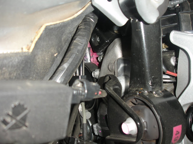

This picture is from the top view. Looks like its leaking from somewhere near the belt and pulley.

From the looks of the location of that dried fluid, it could be the water pump. Water pumps have a "weep hole" that will seep coolant when their seals begin to fail...it could be the weep hole letting out fluid, or simply an improperly installed water pump, damaged pump gasket, etc.

Took the car in last night and the dealer called me today stating it was a faulty water pump. They are going to replace it and they have given me a loaner vehicle in the meantime. They're ordering a new water pump and the Highlander should be good to go on Friday.
