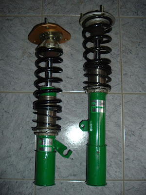

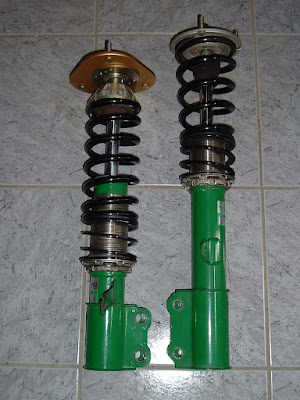

FYI, here's a couple of pics of the AE92 Tein HA's on the left and AE101 Tein HA's on the right. Notice that the brake line
bracket on the 101's is slightly lower. Other than that, the coilovers are interchangeable. This might expand your search
for these items. http://www.jaydm.com/tein/typeha.htm still has a listing for the AE101's...
