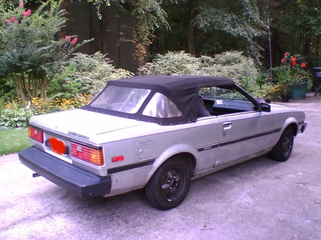

hello this is my first post on here so i appologize if im not following protocol or something but just have a couple of quick questions about my friends car.
he has a 1982 Corolla SR5 with Mercedes Benz convertible top and was first wondering anyone else on here own one of these?
and the real question is he REALLY needs a motor and trans (preferable manual) for this thing and i figured you guys would know if there is a place to get a replacement engine or a RETARDEDLY EASY swap or something. he has NO mechanical skills and i cant be around to help him but if there is a place to get another engine so he doesnt have to pay out the nose for it that you guys know about please tell me. also if any of you live around Atlanta, GA and have an engine/trans for sale (relatively) cheap please let me know. any help would be appreciated
edit: i know this is a noob post to you guys but idk anything about Toyota's or their engines so please dont flame me too bad i am just trying to help a friend out
and here are some pics
Kid in driver seat is owner not me im no where near that stupid looking lol
engine

OK the motor he has in the car is a really good platform to build on. The 3tc makes allot of torque compared to other 1.8L 4cyclinders and people have modified the hell out of these engines modifying it to run EFI/turbo. I would just rebuild the engine, and do a 5 speed swap, and get rid of the emissions
crap and put a webber carb or maybe dual webbers on it. But if he really wants a different engine, the front subframe(minus the steering rack) is the same as the 85-87 corolla so he could swap a 4age into it if he wanted to but he would have to convert to a fuel injected gas tank or race cell and then there would be a ton of wiring. But your best bet is really just a rebuild and then swapping bigger carbs on it . But as for other engines your "could" put in it that i have seen :
22re*
22re-t
3s-ge
3s-gte
3t-gte
2tg-jdm
2tc
4ac*
4a-gze
7ac bottom end/4ac head *
5m-ge
7m-gte
1jz-gtte
2jz-gtte
1uz-v8
*possible but a downgrade
here a what a 3tc looks like with an aftermarket carb on it
and then here's another one with a efi and turbo setup.

um like i said i dont know anything about toyota engines how hard is a rebuild? he would most likely have to do it himself because he cant afford a shop rebuild. i have worked on my engine (1990 mazda mx6 F2 engine) and am willing to help him but if its really difficult then idk if he can handle it.
also would it be a better plan to go to a jy and grab and engine (same) if they have one and rebuild it or rebuild his?
engine was swapped after first engine had 700,000ish miles on it (body has over 1,178,000miles on it now his grandfather was a mechanic) he claims there is some type of mazda engine in there now even though the pic you posted looks the same so im just concerned if it is a mazda the 3tc will not have the same connections as the one in their now but if the 3tc is easy rebuild and the mazda thing is hard id rather go for easy.

Ok yeah it looks like a 3tc to me . I don't know many carb'd mazda engines that people swap into it. Even if you knew how to overhaul the engine would you have the tools/space/time to rebuild it. Your best bet might be a re manufactured engine i mean you might save $200-$300 doing it yourself but you save time and you have a warranty just in case anything goes wrong if you buy a re manufactured one. On a scale of 1 to 10 . 1 being an oil change and 10 being dropping a jet engine in it and getting it to run on the blood of orphans i would probably put a engine swap at about 6 and and overhaul at a 8 . Yeah with basic automotive knowledge and tools and a good factory service manual you could probably pull the engine and put in a reman one with ease but pulling one and rebuilding it yourself from the oil pan up is very intimidating and time consuming your first time and there are a couple tools most people don't have on hand you will need. So if i were you or your friend i would start looking for a place that rebuilds them because your going to save it in effort and time. But roughly the prices i've seen for the parts runs around $580-750 depending on how "complete" the rebuild is and about $800-1200 for a rebuilt/remand engine. I hope this helps .

Nice! It looks just like mine, but without the convertible top lol. The 3tc is a great little engine, well worth the rebuild. They are almost bulletproof.

That motor shown is surely a 3TC.
They are torquey and reliable. and you can build them a mean as you want.
Having owned the same car minus the convertable top, I'd recognize it anywhere.
I had the 1981 1/2 sr5 sport coupe hardtop.(just like the picture)(same color too) which was introduced later than the other bodystyles.

Guarantee you it's a 3T-C engine. I have the '81 SR5 Sport Coupe Hardtop. Haven't built her up yet, but I plan on taking her far.

that is a 3tc and i would try to find a used 3tc to swap in or
go to the junk yards and look for the same car. i bought my
81 sr5 coupe for 500 running with a 3tc in it in wyoming,
so you better be able to find a used one in a junk yard
for cheap, cause i live with 250l people around me haha
so go hunting in those huge junk yards and find the same
engine and swap it
