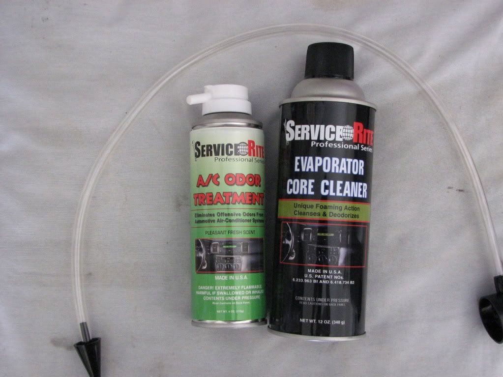

ok guys here's a simple DIY u can do to get rid of that nasty smell when u flip the a/c on. it took me 1 hour to do with taking pics, but u can do this in under 30 minutes. the dealer sells this service in a combo pack along with replacing new model cars' cabin air filter totaling $100 with tax u can do better things with your money than that. here's what u will need:
jack stands or wheel ramps
A/C odor kit
drain pan
safety goggles
rags
i bought this kit from the dealer for $23. LARGE PICS AHEAD!!!!
sorry i couldnt seem to flip it around i'm still trying to fidget with the photobucket features so bare with me here guys.notice how the tip at the end has a cone shape. this end u wedge into the evaporator drain tube. see below
this is the tip here. other kits just have just a long hose without this cone wedge at the end, whatever kit u buy be sure it comes WITH a hose bcuz u cant do this procedure without it.

that boot is the steering rack boot, u may need to actually use jack stands to lift the car high enough to reach the tube. i'm not a big guy so it wasnt an issue for me. the evaporator core is subject to growth of fungus, mold, etc. this can produce a foul smell when u flip a/c on. if your drain tube is clogged then this problem can get worse. its also bad in hot and humid areas. the cleaner is basically a foam which expands to fill the evap core and washes out all the nasty shit growing in there or stuck up there. i strongly suggest u hold the hose with 1 hand and use other hand to hold the cleaner can. the hose can fly off the can with pressure and spray everywhere, this is why u NEED GOGGLES!!! CAUTION: once u empty the entire can into the tube and remove the hose, the foam will begin to liquify very fast, wear goggles and put a drain pan underneath to collect runoff. this takes about 10 min to fully drain evap core.
