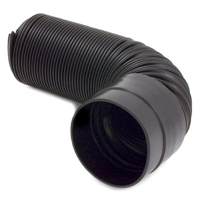

Since I had a problem using the 1ft PVC that Hummer suggested, wouldn't the accordion pipe from Spectre be a good alternative?
