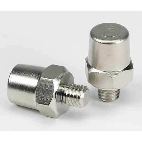

Least expensive way to do it is to get some studs like these, for the OEM cables, mount them block that will insulate them from each other and from the car itself, crimp some ring terminals to the new cable, and bolt them to the stud. Lather everything up with dielectric grease or silicone to prevent moisture and corrosion - and your good to go. Hardest part is finding the small bits - try an audio shop, Crutchfield online, JEGS or Summit Racing, or similar.
