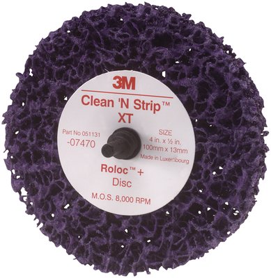

use a heat gun and heat the glue (on the molding) then rub it off, after that use thinner to clean it
then use 3m 2-way tape. put 2 way tape on the molding first the press the tape so it sticks then clean the car then put it on
u can get this from CT
http://multimedia.mmm.com/mws/mediaw...dddV5fpgDDDDC-
