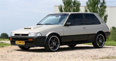

I drove in a Corolla AE82 with 4A-GZE of a friend of mine a while ago and we kind of played with a other clubmember with his Corolla AE101 Blacktop on the highway. Trust me...The Blacktop wasn't able to keep up, even at high RPM's
By the way, although not a AE92...still a very nice car! The AE82 with the GZE:
