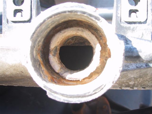

Following up here with the (hopefully permanent) solution to my issues from the past two months. When we left off, I had purchased a Celica at auction with unknown repair history. I had just finished a head gasket repair and was running the car for the first time and was getting foam and steam pouring out of the overflow and constant bubbles from the overflow with the cap on. (new cap I should add) It was not overheating per the gauge or an IR thermometer.
Turns out there were several things wrong that I overlooked. When I did the repairs, I was only replacing as few things as possible to keep costs down. Someone told me "I'm still going with leaking combustion into cooling systme based on your video, unless the radiator cap is shot and not holding any pressure." I had replaced the cap, so I thought this could not be the issue but it was..
Here's how it went down:
I ordered an Aisin complete water pump with housing, was shipped the wrong part, sent back, received correct one and installed on the car. I read up on my after market thermostat and discovered that there was a bleed "notch" that needed to be installed in the 12oclock position. This was in place of the OEM Thermostat bleeder jiggle valve. With the new pump, Immediately the system started acting close to normal. The air bled out in large bubbles and the interior was blowing warm air almost as soon as I opened the heater valve. (before when I was getting all the foam, it took a long time to get heat in the interior) Once the thermostat opened, the water began to circulate in the radiator and all appeared normal. I put on the cap and went for a test drive to my neighbor that is a mechanic. All appeared normal except when I revved up the engine, I could see the coolant rise in the overflow and spill out a little bit. What the heck? At the same time, the upper and lower hoses collapsed a little bit and my mechanic neighbor said "you need new hoses" So I went to Autozone and got some new hoses that the counter guy said were "already cut-to-fit your specific car" brought them home and they didn't fit at all and even with cutting would have been a horrible fit. Returned those and bought new from dealer, but...the hoses from the dealer new were just as soft as my old hoses. Going with the neighbor mechanic's theory that soft hoses were my problem, I was back to square one. So I started to look at things more carefully with the voice in the back of my head saying "check the cap..." Upon careful examination I noticed that the seating surface inside the neck of the radiator was worn and corroded and the cap's inner sealing plunger was not sealing. see picture here:
http://picasaweb.google.com/mjzraz/C...80560663752418
I ordered a new Koyo plastic/aluminum radiator and it came this week. I installed it, hooked up the new hoses, bled the air and took it for a test drive. All appeared well. My daughter has been driving it the past few days without a problem. I will probably drive it to work a longer distance a few times before I let her have it full time. I am wondering if I should get a Toyota cap to replace my aftermarket (gates or stant) one. When installing it, I barely had to compress the spring to lock it in place. It appears to hold pressure. She just stopped by and I checked the overflow level and the level was fine and the hoses were firm as if they were under slight pressure.
So far so good - Thanks for the advice!
