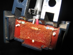

Old 08-11-2006, 01:43 AM   #10 (permalink)
Midnight87's Avatar
Join Date: May 2006
Location: Omaha
Posts: 70
View Midnight87's Photo Gallery
can you tell from this picture what type of
resistors I will need to solder between the new
switches?
there are only 2 wires but 3 resistors, is one shared?
Midnight87 is offline   Reply With Quote
Old 08-11-2006, 09:30 AM   #11 (permalink)
Got Hardass?
Jeeves's Avatar
Join Date: Aug 2004
Location: Albuq, NM.
Posts: 2,955
View Jeeves's Photo Gallery
That's what I thought. It's actually a circuit, not simple momentary switches.
My guess (without seeing the PCB) is that those two wires are either normally open, or normally closed. Now, when you push a button, it throws that resistor inline, the ECU goes "Ok, is that.. uh... 2700k Ohms? Yep, Ok, Cancel Cruise Control. However, this is a guess, I can't see the traces to tell what it's really doing. For all I know there could be more or less going on (It could stack the resistors or who knows what).
