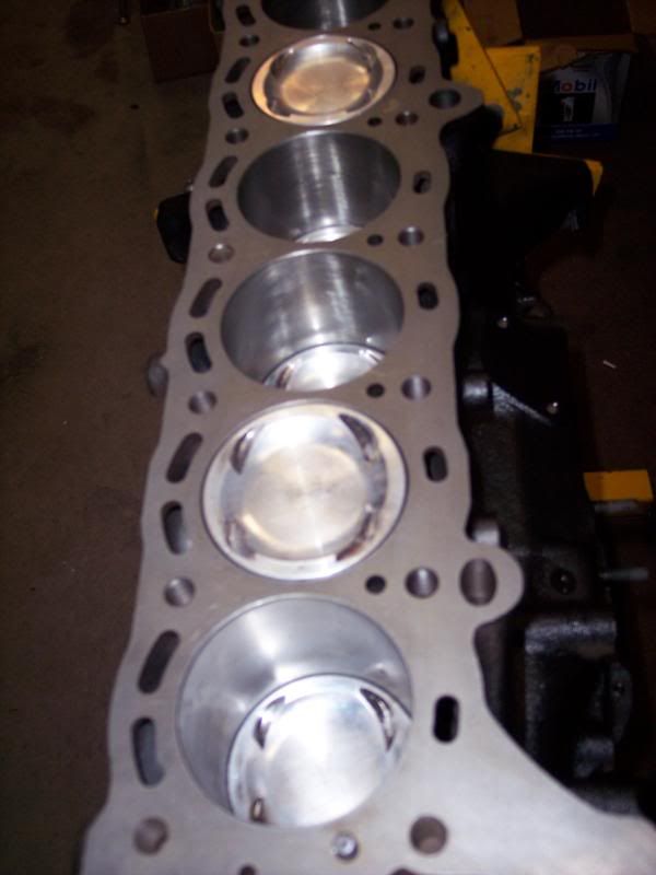

Well I finally have made some good progress on my rebuild, just in time for the end of the season.
Pics.
What it looked like complete at the beginning.
Why I had to rebuild.
I am building a new special manifold just for the new setup, that should pan out to be rather cool.
And unrelated our 2jzgte swapped 87 held up great all season long, put down 550rwhp at 22psi, and ran a 12.3 at 18psi.
This spring is going to be a very fun one in deed.
