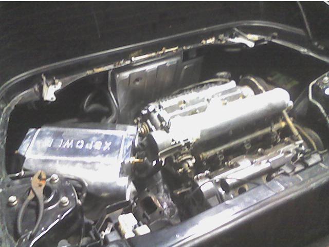

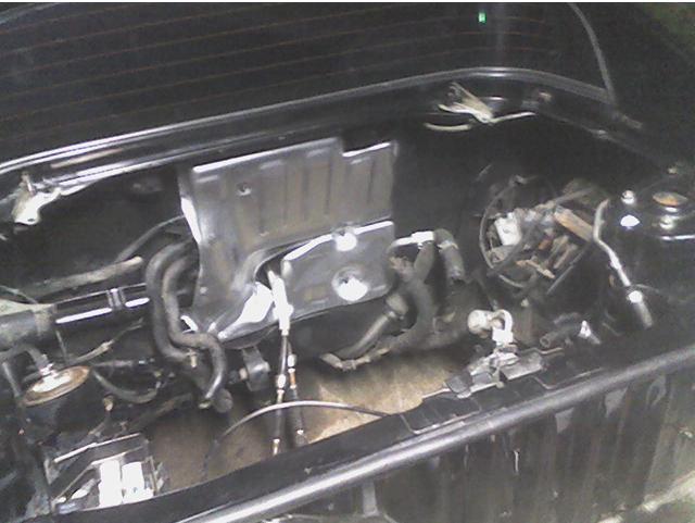

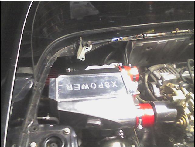

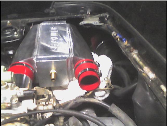

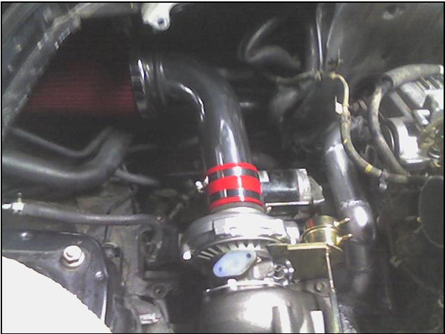

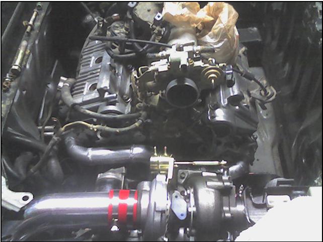

I thought you guys on TN may appriciate a little look into my new build. We are calling it the Wraith and asside from the Auto to manual swap, Ill let the pictures speak for themselves. Most of this is from the mr2board.com but not too many people frequent there yet.

Build component list:
3.4L Toyota 5VZ-FE
74# valve springs
W255 Fuel Pump
T3/T4 Hybrid Turbocharger 60 Trim
Air to Water IC & heat exchanger (temp controled)
Persek Brothers variable water injection system.
Persek Brothers intake manifold
Persek Brothers motor mount adapter kit
Wolf Catz fuel rails
Camry A/C compressor
MR2 turbo cruse control system.
Aeromotive clone fuel pressure regulator
MS3 Engine Management System
3VZ-FE ignition components
New 93 end links & ball joints
TRD dampers w new OEM springs for now.
MR2 V6 with an inordinate ammount of boost www.V6MR2.com

Miltdoggie, your parts are ready. I think they ship out monday. Let me know what all fits and if you have any trouble getting the passenger adapter mount to work. It may require the MR2 mount aswell. Your the first person in the world that I know of to attempt to install this motor into that gen camry so we may run into a couple of snags but im here for you if have trouble. Call me tomorrow I want some quick shots of the mount location to make sure the one I made will clear everything.

So where did you get the mounts for that? And do you think that they would work in a celica 93 with the 5sfe? I was looking at the camry v6 and it sounded cool vs. the 3sgte just to be different but didnt know if it was even possible?

He customed the mounts himself, and that V6 is out of a tacoma.
