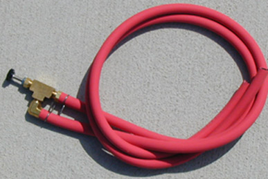

Anyone ever use the MBC from Twos 'r us??
Seems way to simple....

Its actually one of the more popular MBC's of the MR2OC community, its the one im using on my setup, you shouldnt have any problems if you install it correctly.

Im using that same one aswell. I installed it backwards 1st time and my boost was spiking, but then I smartened up and read the instructions, properly hooked it up, and properly disabled T-VSV with the supplied caps and ziptie and all is good.

I see a lot of talk about it on MR2OC.... just wanted to make sure it was a good product. Thanks guys!
EDIT: Did you guys disable tsvs by caping the wastegate actuator and the hose that goes into it? Seems a little shady, wanted to know if it worked.

Yep. Thats how i did it. I used the cap they provided in the MBC kit, and the plug they provided to plug up the hose going to the T-VSV.

or you can unplug the T-VSV electrical connector
