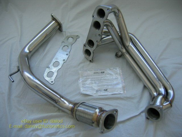

here's the header setup I've been looking at... the only problem is.... I don't see anyplace for my egr...

I went ahead and purchased the OBX header\mid-pipe..... and an ANSA muffler. yeah, only one... I guess it one muffler looks odd under there, I can always throw another one on..... I just have to het this mother running before school \ nopi nationals

here's a picture of the OBX header assembly with mid pipe....
