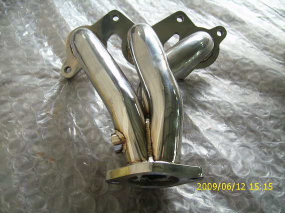

Please post more pictures of the custom header you made for the V6 guys to see. I am positive you would be able to sell many of these headers if you could design one for the Camry.
actually, i need to confirm them on a Camry, but i am fairly certain they will fit a Camry as they are.
here's a picture of the latest one (one design fits both sides):
the only difference between this one and the production one should be the O2 bung. in it's current position it restricts the flow of cylinders 1 & 6 a bit too much. I'll be moving it a few inches down to the Y pipe
I should have them in stock in a month or so. there were a few delays due to revisions, but I'd rather get them perfect than quickly.
The MR2's Y-pipe (that i haven't started making yet) may or may not fit the Camry. but I'd bet it will hit the passenger compartment and won't be able to be used.
*edit* if anyone is near Fort Wayne, IN with a 2GR-FE camry. please contact me. you may end up with a free set of headers for your camry.
