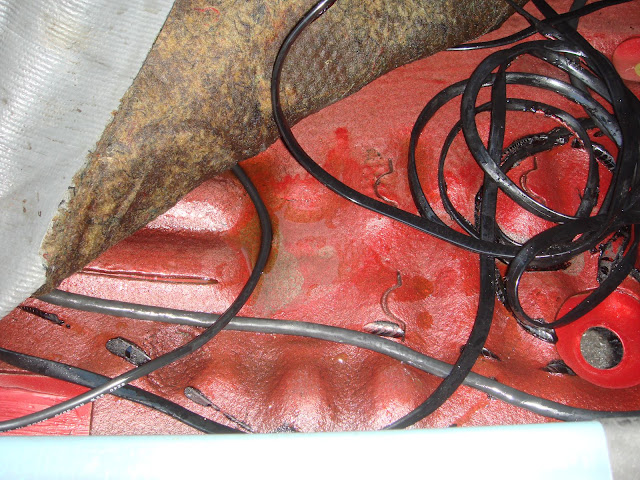

So this has been baffling me for some time now. I just noticed the front passenger floor to be wet, very wet. At first I thought someone's water bottle spilled, then I realized it's taking forever to dry. I decided to use paper towels to soak up some water but soon realized what I really needed was a cham-wow to deal with this.
Next I went and used those wet/dry vacs and decided to shampoo the carpet in efforts to clean it up. Today, 2 weeks later, it's still wet. So I decided to take a look under the carpet and behold......puddles. I popped the plugs to allow it to drain.
I felt around and nothing seems to be dripping? Where else do you think I should check??

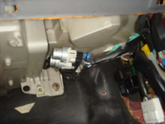

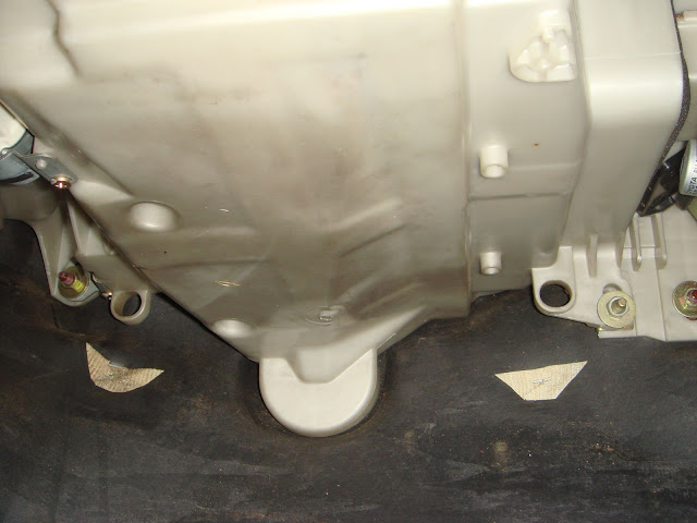

I think you may be on to something here. It seems like all of my coolant has leaked out and right now I have just water in there. I was planning on adding some Toyota Red coolant but now that I think about it, I think i'll try to replace the heater core.
Oh, and it has been raining allot but it's been dry the last 4-5 days and some days have been hot, but my carpet is still soaking wet....and I still do use the heater at nights whem I drive with the sunroof open.
Is my heater core visible in those pics I posted up?
Thanks.

Could be something like a windshield leak. If it were summer and running the A/C, sometimes the drain gets pulled up from the hole through the floor and will soak the passenger side, but if you have anti-freeze in your coolant then a white paper towel used to soak it up should show the color and you should be able to smell it. If it's anti-freeze then you can bet it's the heater core or the hoses to it. Either way you'll probably have to remove the core. It should be in the plastic housing (plenum) behind the glove box. Some are easy while others are pure he**. Look at the firewall under the hood for the two heater hoses which go through it to the heater core. This will help locate it for certain.
