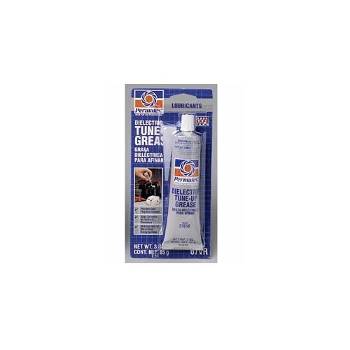

Ignition componets damp or damaged. < when we put car togeather we used Electrical connection GOO it realy helps, apply it wherever u conenct stuff, keeps the moisture out

Faulty coil or its disconnected - Could be, i put a bunch of Electronic goo all over the connections of mine and so far so good.
Since its all electronic, if ur not getting firing it might be the FUEL or air delivery too. Thats the problem i had, u can try to start car by just spraying a SAFE EFI or carb cleaner can, its preaty cheap and if the car coughs and tries to start it must be fuel. If it doesnt, might be air or electronics, which is a pain Usualy electronic stuff will still let it fire a bit. If u want to check it u can plug in Computer at worst.
Proper name is Di-Electric Grease
