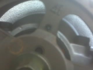

Here's what I think! Might possibly, my engine be 360 degrees off? The cranks that is... Instead of on compression cycle it's on exhaust cycle?
My timing belt is on target. If the notch on the crank is at 0 degrees, and the 4e on the cam lines up with the dot on the valve cover or head, and the distributor points to #1 on the dist cap... Then everything is lined up on the timing belt.
What should I try next? Should I turn my crank 360 degrees and adjust my timing belt?

The timing ring on balancer can slip so pull plug #1 to confirm tdc. The distributor can't be mounted flush unless pointed the right way. The cam notch is off center to assure this. Check compression and do a leakdown test. You may get lucky and have bad wires.
What good is the timing ring if it can slip? You'd think they'd mount it in such a way that it'd be a reliable source for timing your engine...
Edit: This slips?
Also so this isn't TDC? With my cam pointing at this notch?
In that picture, if my engine is TDC, then my cam shouldn't be lined up at that?

Top picture, the outter section is mounted to the center hub via a rubber insulator. After so many years plus solvents and chemicals spilled plus the heat cycles tend to make the rubber condense and shrink. This no longer provides the same tension and allows slippage.
The intake cam appears to be lined up properly, is the exhaust cam lined up properly with the intake cam?
Totally unsure how to do this, but bare with me. If you describe it I can do it.
Uhm... I actually only have 1 cam on the outside (that I know of)... I was told it goes into the valve cover and spins 2 cams... I don't know.

can you zoom out a bit on the cam lineup pic? Hard to tell angle of cap. Normally there's a . and a | on the cap. The hole in gear aligns with | but I'll have to look manual for bottom lineup without cover.

Uhm... Ill try to get you the picture as soon as possible today. I don't think I can upload a pic from my phone to photobucket.
Any other questions? I check the forums several time a day. I'm pretty desperate.
Edit: Okay here's the pictures... Completely unsure of what you wanted me to take pictures of. So I took all kinds of pictures of the timing... eh heh.....
EDIT: OH YES! I forgot I pulled my spark plug, and when my cam is in THIS exact position... Cylinder 1 is on top. What valve is open at that time I have no clue lol.
I stuck a long straw down in the hole, and rotated the crankshaft with my hand and watched the straw. It's highest point is definitely when the 4e lines up with that dot shown in the pictures.

Hmm... I did all this before. I think I even mentioned here or somewhere else what I used to stick down there to watch the piston rise and fall. It's actually in the same post as the one where I mention the year is a 93. A straw, just like you said. It's the only thing I had long enough lol.
I'll take another look at it tomorrow just to triple check. The valve cover is still off.
The actual piston is at TDC (has been for days while I just stare at my cams clueless)
My 4e hole covers the dot where the 5e hole covers it in that guide... But my cam gear has a 4e hole and a 5e hole - if it matters.
My 2 cams meet (can't see in the pictures because yeah they're blurry) but the two dots meet perfectly together when all this is lined up.
My dist is all lined up and so are my wires.
If I have time, I'll put on my new timing belt tomorrow and look at the actual pulley gear.
1 last thing... In that guide he posted, it says do not turn your engine a certain way... And I have. I can't see how it would matter - but I just grabbed the crank pulley with my hand and spun it backwards just to line everything up 1 day... I thought it would be easier than spinning the pulley twice to get everything to line up. I didn't know it had to be directional...
