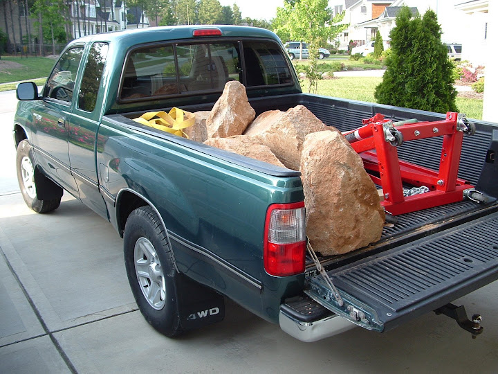

A few weeks ago I picked up about 1500 lbs of rock (see pic) and last weekend I had probably 500lbs more (fewer rocks but twice as large) and it did great - I've got to get under the truck to make sure I didn't crush any of the bed supports and make sure the springs aren't cracked. I'm pretty sure the rear shocks are cooked but they were old anyway.
