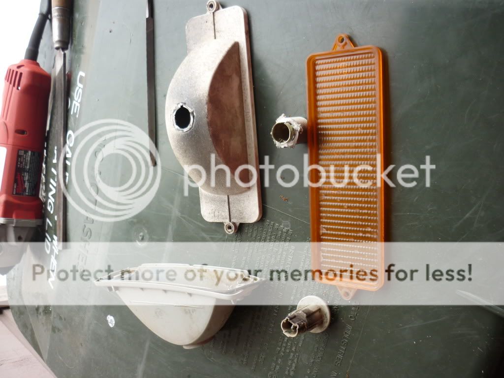

Finally hooked up the turn signals on the new bumper. One side I was able to just hook up the wires into the OEM connector. On the other side the light bulb socket had no wires and the socket was corroded. Didn't have my soldering gun so I retrofitted the stock light socket into the TJM turn signal. Little tedious, but works great.
Old light bulb socket cut out.
OEM light bulb socket retrofitted.
From the inside the light housing.
