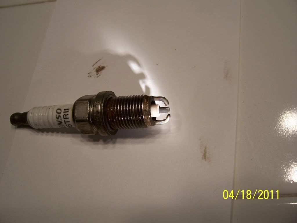

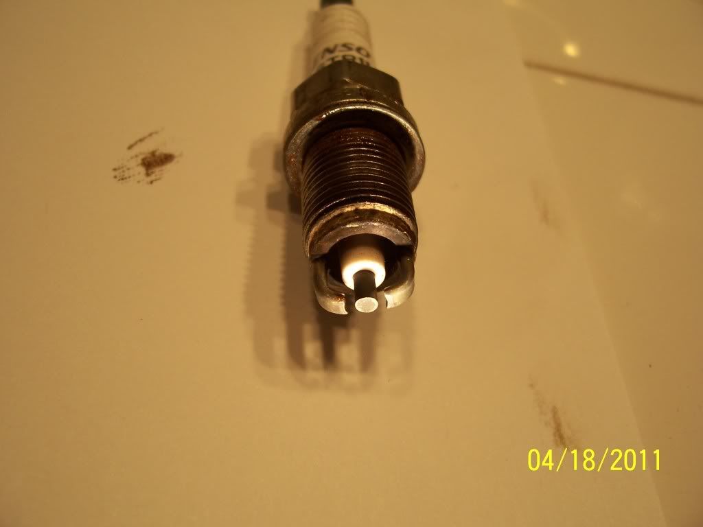

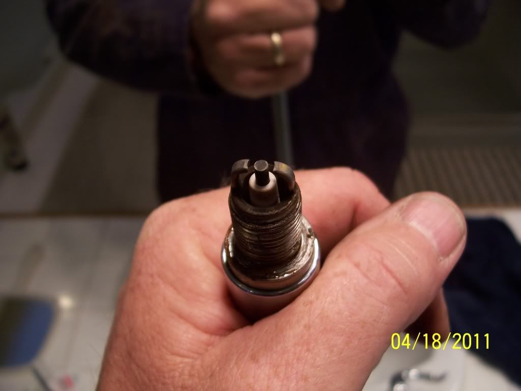

; ;; Hopefully these pictures of the plug from #6 cylinder came over.
Here is the notes off the last dealership ticket: "Performed Compression test on all 6 cylinders 1)160, 2)160, 3)165, 4)170, 5)165, 6)160. Swapped coil pack, plug wire, ecu & igniter, slight-misfire was present in all situations. (spark Plugs and #6 Injector previously replaced). Bore Scoped Cyl #6 could not see anything abnormal, have eliminated fuel & spark as a cause. Problem must be mechanical eventhough compression is good (have had sunken valve seats test good on Compression but still cause a miss). Recommend removing left cylinder head for inspection."
I don't want to pull the head unless I know that is the problem so any Ideas on things to check would be appreciated.

Try swapping the plug with another cylinder and see if it follows the plug. Plugs can go bad...even brand new.
Was the problem there when they installed the new plugs or after they put them in? Are the spark plugs all the same model/type? How does the condition of the #6 plug compare to the one of the other ones? Looking at yer piccies, it seems that #6 is firing.
You could try a leakdown test...
