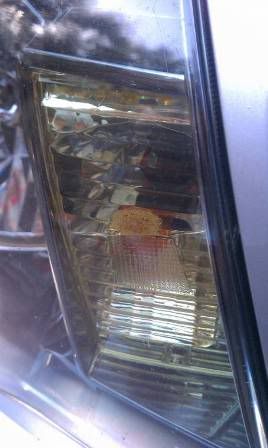

A crack caught my eye on my 2009 Tacoma’s Daytime Running Lights (DRL) or DTRL as it is sometimes called. Upon further inspection I noticed that both the right and the left DRL were burned and cracked. The DRL was a factory option as I bought the truck the same day it arrived on the dealer’s lot and the DRL was already installed.
I searched this forum and others and found that the issue has been well documented. I took the truck to my local Toyota dealer’s service department and asked them to take a look at the lights. The service advisor saw the burned and cracked lens and said they would need to diagnose the problem. They asked if I changed the bulbs and I said no. Then they checked the mileage and I had 40,200 miles so they said it was out of warranty and therefore would not be covered. They offered to check the price on a pair of headlights and said it would run about $600, but they did not actually check the price to give a firm quote.
I had previously purchased the 7 year 100,000 miles Toyota Factory Extra Care platinum Zero Deductible Warranty for $814 from Jerry Johnson with Midwest Toyota (I found his contact information on this forum- thanks! ) so I decided to give it a try. I told the service advisor that I have a Toyota extended warranty, so he checked their computer system and couldn’t find it. Then he called a number he had on a paper on the wall to verify coverage and they said they had no record of my contract.
I took the contract out of my truck and called the number on the contract and they confirmed that the policy was valid. They explained that the Toyota extended warranty plans were underwritten by different insurers depending on what region of the country the warranty was purchased in. They said that I could still get service at any dealer but they need to get pre-authorization by calling the claims number listed in the policy.
We set up an appointment for me to bring in the truck the following day and he jotted down the information about the extended warranty. The service advisor called me back later the same day advising me that the extended warranty denied the coverage. I asked him to schedule a meeting with the dealership’s general manager for me but he replied that I just had to go and see if he was available.
I looked up the warranty brochure and there it was, under “What’s Excluded” it lists …Lamps (Back-up, Fog Light, Side Marker, and Turn Signal Light Assemblies); Light Bulbs… At this point things were starting to look like I was SOL, but of course, I didn't stop here.
I called Toyota Customer Service using a phone number I found in my owner’s manual. I told the representative that my vehicle’s DRL were burning through the lenses and that I was afraid that it may catch on fire and cause a safety issue and that the dealer refused to even diagnose the issue because the truck has 40,000 miles. I told her that I was a member of Toyota Nation, a Toyota enthusiast web site where Toyota owners share their experiences about how great their trucks are. I mentioned that the site had numerous posts from other that had experienced the same problem and that it is well documented and appears to be widespread. She asked if I had brought this issue to the attention of the service manager and I mentioned that I asked the service advisor to set up a meeting with the dealership’s general manager but that he said I would have to go over there and see if he is available. I told her that I don’t have time to be playing games chasing people down and that is why I was requesting to setup an appointment. She said that I would be receiving a call regarding this issue.
The service manager called me later the same day. I explained the same things I told the Toyota Customer Service representative (plastic melting and cracked on both sides from the inside, my concern that it would catch on fire, and that I’m a member if Toyota Nation and the “defect” is well documented online. He said he would see what he could do and then call me back. He called me back the next day and said that they would replace both headlights at no charge. He said he would need to order the headlights and that he would call me when they arrived. Several days later he called and told me that the headlight arrived. The following week, I took the truck in and had both headlights replaced in about 1 hour 15 minutes.
I asked the service manager what I could do to prevent this from happening again as a typical summer day is over 100 degrees here and that I believe the lens may start to melt again. The service manager confirmed that Toyota is aware of the issue and that they have redesigned the inner DRL lens to prevent it from melting. The invoice from the dealer had zero totals and statement that said something to the effect of “goodwill as per _____(first name of service manager)” This makes me wonder, does the service manager have the authority to authorize out of warranty repairs or was he simply conveying a decision made by higher-ups at Toyota?
I’m not buying that the lens was redesigned, so I’m leaving my headlights on for now (which keeps the DRL off) until I have a chance to install some cooler LED bulbs.
In this case, I recognize that the truck was outside the original factory warranty period, albeit only 4K miles, and that the extended warranty specifically excludes this coverage. In my defense, I dont think all the damage happened in the last 4K miles I had simply failed to notice it. I'm very happy that Toyota authorized the repair because this is a slam dunk case of a factory design defect as the lens were not designed to withstand extended DRL exposure in very hot summer weather.
I was considering filing a complaint with the NHTSA reporting the issue as a possible fire risk and maybe then Toyota would have to recall and replace all defective headlights not only those whom, at their sole discretion, they "feel" like replacing. I’ll hold off on that unless others in this forum have unresolved complaints for the same issue.

Yes, this is ++ well known. Even more weird: I ran over-wattage bulbs (until they burned out due to shortened life) & no melting.
I suspect, and it's only that, a personal opinion, that there have been several different suppliers of headlight assy. over the many years since 2005.
Some appear to use a weak plastic.

It bothers me that they replace the headlight housing, but not the bulb receptacle which also gets hot and brittle.

There is a fix if you're beyond your 36/36.
A T20 socket, a 7440 na bulb and the heat is way down, the bulb is further back "away from the lens" and the brightness is sooo close to stock that it's unreal.
You can also go with the 7440 clear and you're talking brighter than stock and with no chance of smokeing those lenses. And the single contact bulb will work just as good as the dual.
Thats what I'm doing cause I ain't takin no chances on the dealer kickin in till this thing goes to court!

I just noticed that this is happening to both my DTRLs. They both just cracked. So now they are melted and cracked. It looks bad. I called Toyota and they told me this is the first they have heard of this. I think this is BS. I am at 58k miles. 2009 Toyota Tacoma TRD Off Road.

I switched out the bulbs to a lower wattage because I was worried about cracking/melting. I later installed a switch so I can turn them on and off when ever I want. Good luck finding new lights.

The good thing about the later design headlights for the newer model Tacomas is that there's a large space between the bulbs and the plastic lens. Maybe they learned from the earlier ones.

Yes, the front was restyled for 2012, and the new headlights don't have the amber inner lenses on the park lights. So no issues with the 2012-13 models (so far), although I don't know if we'll see the same socket overheating problems. When I got my '13 I considered keeping the DRLs switched off, but, I'm using them.
