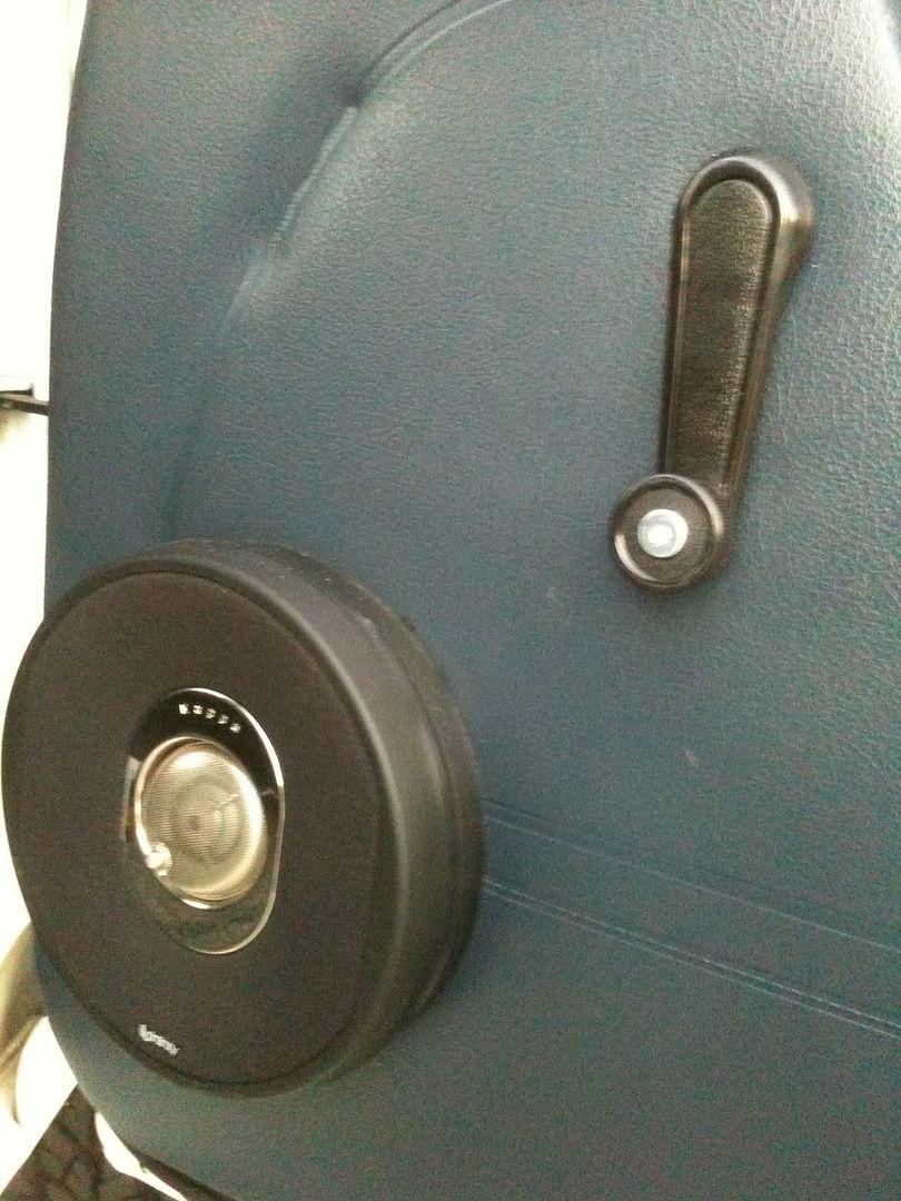

Did a little mod today that others might be interested in,
Well, when i got my truck, the window handles were broken off, the thing that turns with your hand. so i replaced the whole thing, and broke two more sets since ive owned the truck. SOOOOO i did this.
Just drilled out the center and used an allen head bolt with a shallow nut on the back end, probably best to use a nylon lock nut, and dont tighten it all the way so it still rotates.
