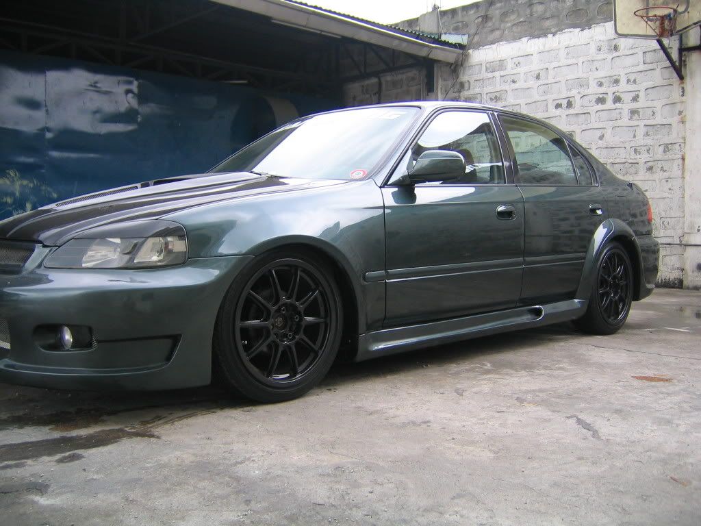

here is an example of LOW OFFSET AND FLUSH FITMENT
