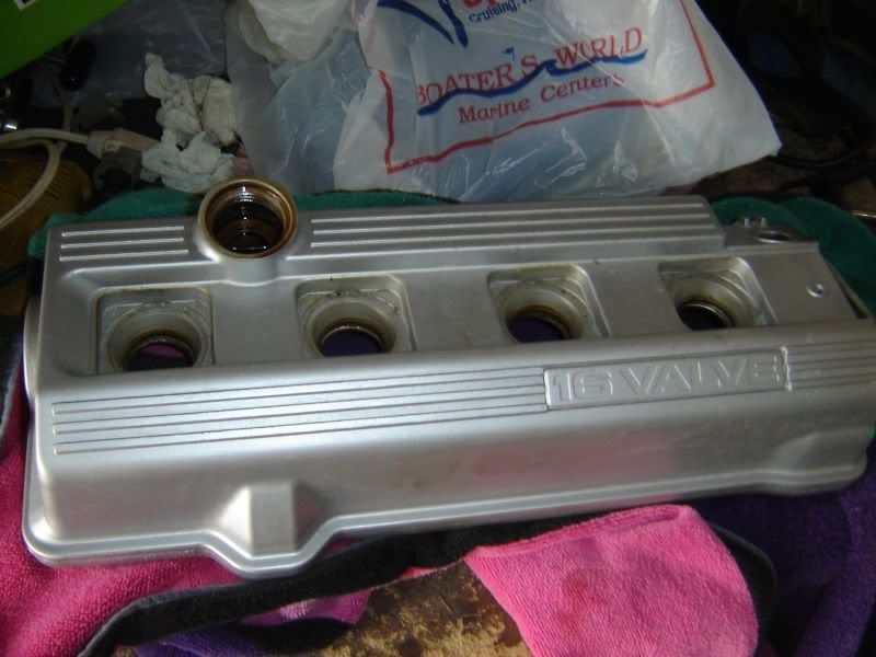

This is what it looks like under there if your curious.
Remove the rest of the parts and clean them up, replace the gaskets if needed.

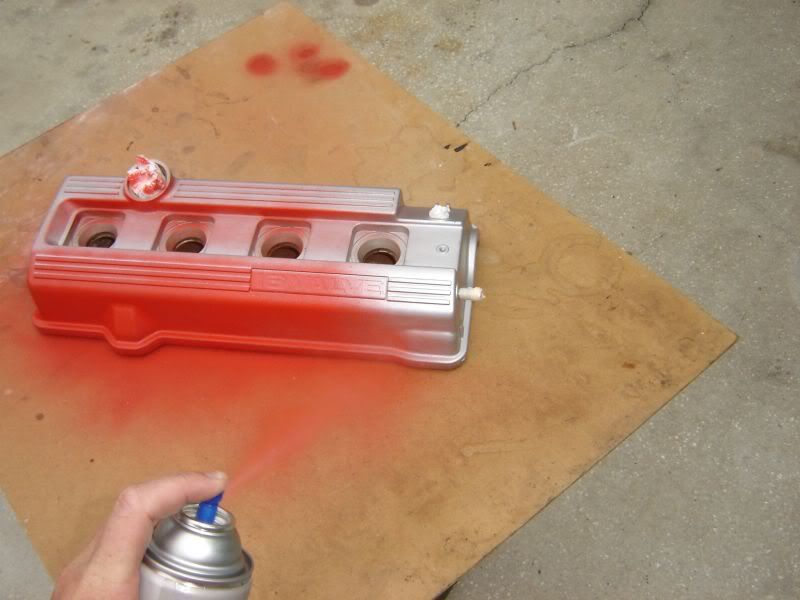

If your painting.

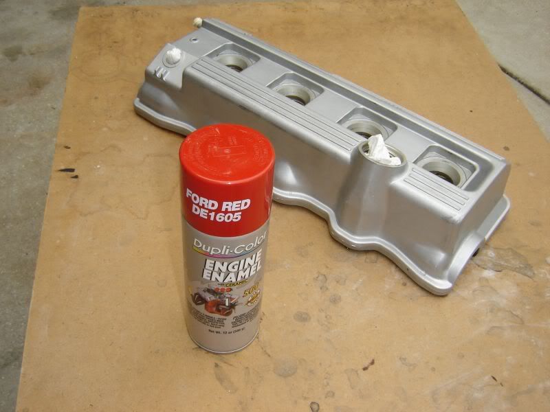

Wash down the valve cover.

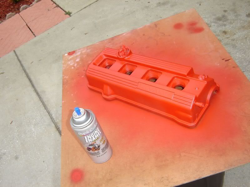

I chose Duplicolor Red 500* paint.
Apply Even strokes. 3 light coats is better than 1 heavy.

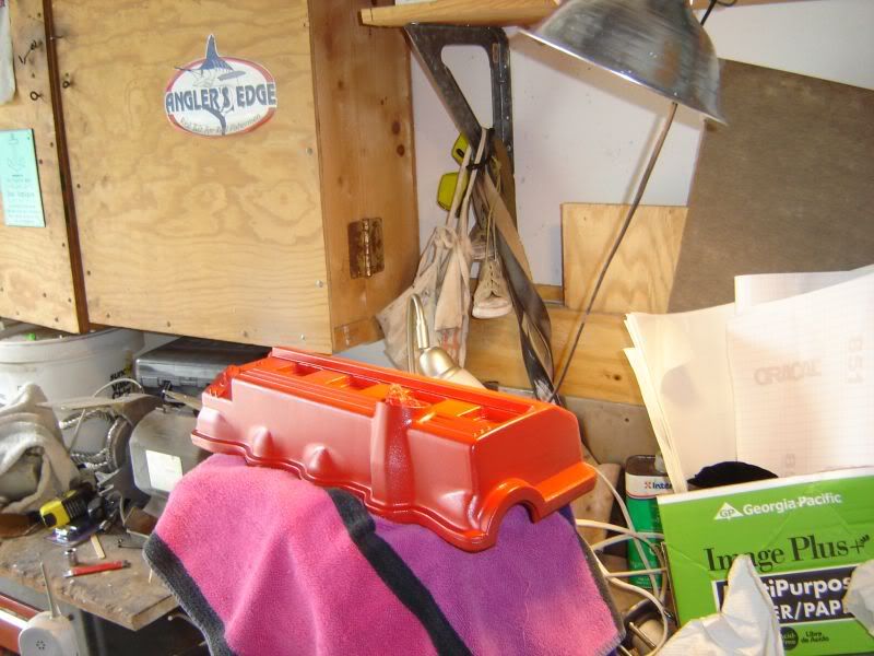

Let Dry for 1 hour (says shorter time but safer than sorry!) I put it in a lamp to dry out the air too

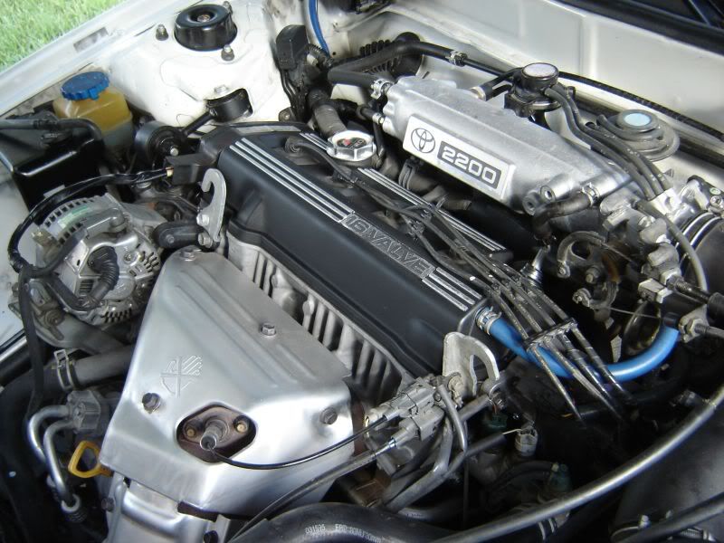

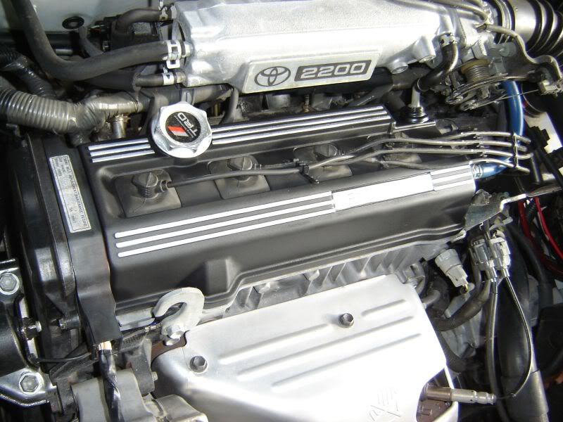

Here are finished pics after I made it black and silver :thumbup:

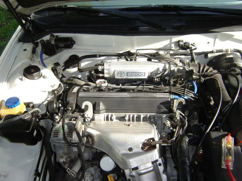

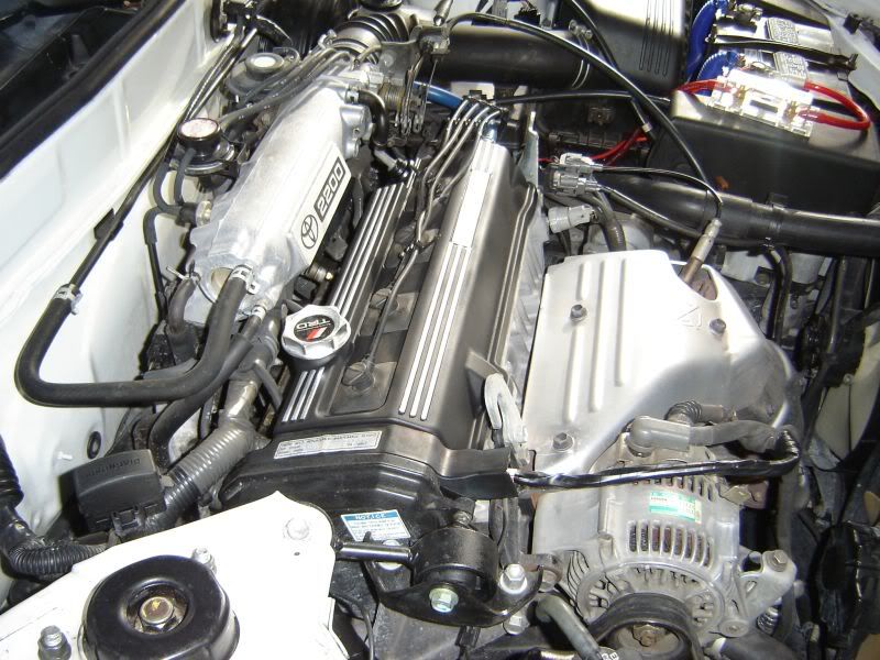

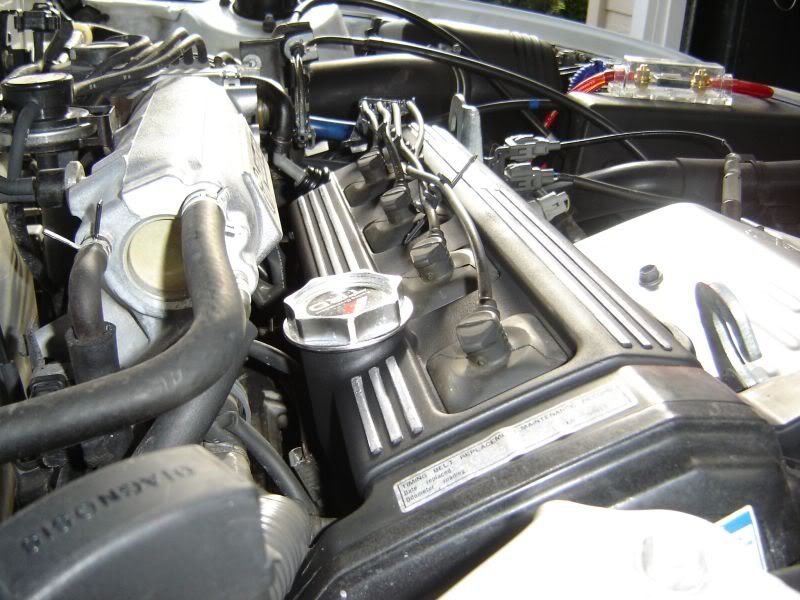

I finished the cover. Its just the start of repainting everything, so it looks odd right now. Dont worry ;) Although I might change it to black and get red spark plug wires. doesnt matter its going to look great when the whole thing is done. I can only paint a few hours of the day before it rains.
Spark Plug wires were not put in in this pic. Also its dark because its Florida, it rains everyday in the Summer.
Everythings a mess... wire loom gone so it looks like ass aahhh its not like me lol
Yeah, I was kinda of wondering why you chose red, with the blue wire looms. Now I see that you have red battery cables as well, so a red/blue scheme would look alright. I think it'd be totally sweet if you left it red and sanded off the paint on the ridges and in the recessed area, where the numbers are, kinda like th viper head covers if you've ever seen those. Well, those don't have the ridges, but you get the idea. I'd do it to mine if the 1mz valve covers had all that fancy stuff on them...they're just plain valve covers with the coil packs on top. Anybody know if there's a better looking v-bank cover (I think that's what it's called) than the cheap plastic one that comes with it?
Well. I didnt take off the blue loom on some areas because its just loose wires and I dont want to create an un-needed fire harard. lol. Ive already made up my mind, Im changing the valve cover to black but will keep the red stripes on top and do something about the 16 valve. Everythings going to be black, wires and vacuum hose will be red to accent it and the silver will stay with the intake manifold and all.
Soo all in all, its changing once again, but atleast I got to do a write up.
