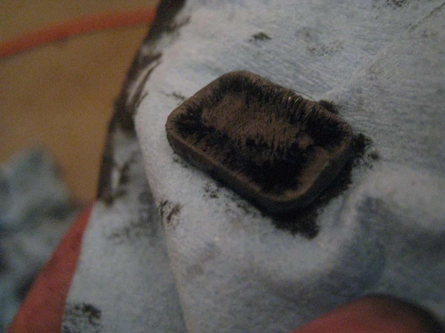

Words can not describe how much I wanted to take a hacksaw to that frame member...That thing was such a PITA to work around Those 4 that are under that frame, that took forever to get on/off. It took even long to get the freaking screw threads to catch to put them back in....lets just say there was a lot of cussing/cursing/yelling/whatever..I think I got my point through, needed to vent
ANYWAY, here are a few pics I took along the way:
I just thought this was funny, the parts guy gave me a weird look when I told him I needed 12qts of ATF WS, it ended up being an entire box. Another thing I found funny. Online retailers wouldn't ship me WS because their shipping company (Which was Fedex) considers it hazardous. Well label on that box, it was delivered to the dealership from a distrubution hub BY FEDEX.....wtf
And now, the color difference, obvious which side is new. It look like muddy water...
On to the magnets, mine didn't look anything like yours, mine shows the 100k miles. Dark fluid (I did a 3.5qt drain/fill 35k miles ago), COVERED magnets, I cringed a little bit. The magnets were absolutely covered with a magnetic sludge. I wiped most of it away, and there were still some metal filings, but it was more than I'd like to see...
(The picture above, the sludge is twice the thickness of the actual magnet)
(post wiping away the magnetic sludge)
Anyway, buttoning it up, all nice and shiny...
(and I just realized thats a pic of the old filter... )
The way i ended up doing it, I drained the fluid, swapped the filter, put in 5 qts, remove the line on the transmission cooler, drained 2qts, filled 2qts, drained 2 qts, filled 2 qts, drained 1 qt, filled 1 qt, that left me with 2 qts to get the level right. Took a whole qt to get it back up to where it should be. Now I have a spare qt.
