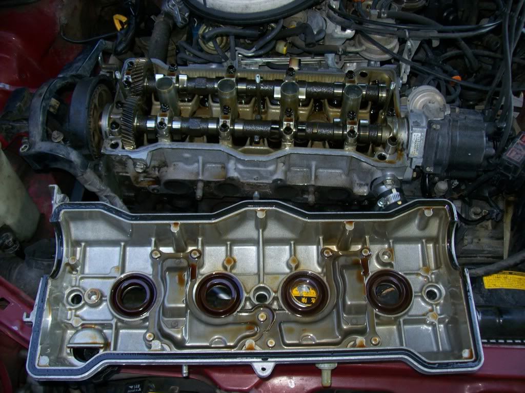

Cover was on there like superglue. Finally broke it loose with small block of wood/hammer and flat blade at 4 corners. Kept thinking there was something else I needed to remove but nope. The original cover gasket LOOKED ok but no way was I going to put that thing back on. New one was only $23US even with the spark plug tube seals. Why risk it?
The only 'real' issue was getting the old plug tube gaskets OUT of the cover. I thought they had been adhered to the cover or something. Had to pop out the centers and then pry (gently) the outer edges off. I got 3 out before I thought to check what side was up...assuming the last person to do this was right...the flat/inset side is UP and the somewhat tapered side is DOWN.

I currently have Felpro as well. Just know how the grommets go on around the spark plug holes. I think mine are on upside-down. But I haven't had a problem since, I don't know.
Here's how they should go on:
