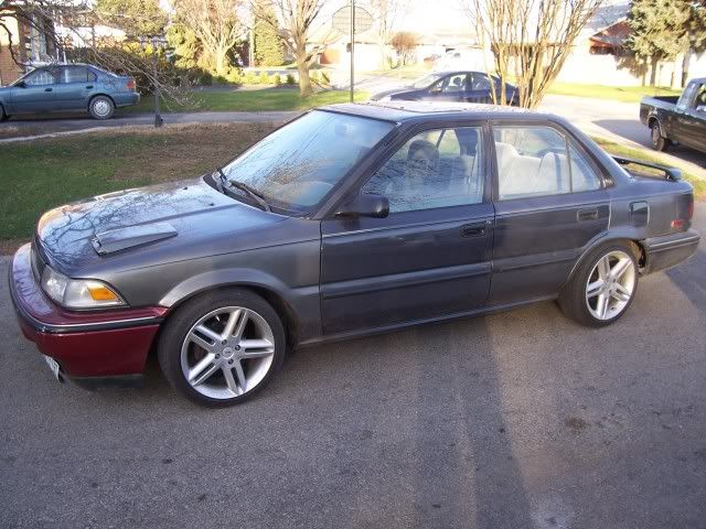

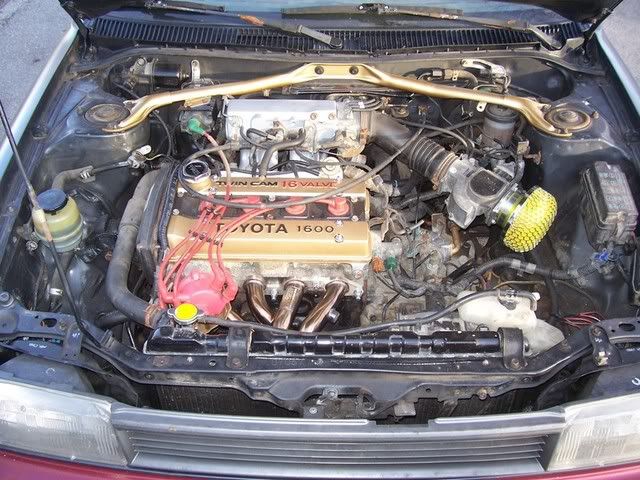

Hello everyone, this is my project I've slowly been working on since may 2006. I've got alot more work planned for it but most important right now is getting it painted this winter. Here is whats been done to date
1988 gts motor and trans
new oem clutch and resurfaced flywheel
all new gaskets on motor and new timing belt, water pump, oil pump
trd short shifter
relocated starter to intake side
battery relocated to trunk
ghetto urathane motor mounts
header plus full exhaust to magnaflow muffler w/resanator
sway bars from gts
seats from 1989 gts (if anyone in ontario has good grey ones from a 90-91 pm me)
rear disc brake conversion
lowererd

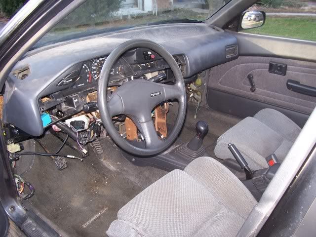

currently working on finishing gts dash swap, not as bolt-in as I first thought but it'll get done. I'll post more pics when it gets paint.

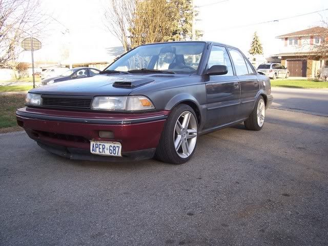

Thanks for the comments. The lip that is in the pictures is from a 1990-1992 volkswagen golf/jetta. But you'll notice the gap in the middle cause its not quite long enough. Try one from a 1993-1998 volkswagen golf/jetta, these ones only require a slight trimming in the middle to fit nicely plus look alot nicer in my opinion.
Corolla SR5
50 Posts
That front lip looks cool. I like it, would look even nicer with the middle piece. If you have a friend that does body work he can probably fabricate the missing piece with fiberglass or something and then paint the entire lip. I like how this car has the classic corolla stance. What color will you paint it?

how long did it take you to do the dash swap? did the stearing wheel go right on, or did you have to swap the column too?
847 Posts
Discussion Starter · #8 ·
to be honest the dash swap is not complete yet and is a pain. steering wheels will interchange between fwd sedan, sr5 and gts with no problems. the one in the picture is from a sr5
