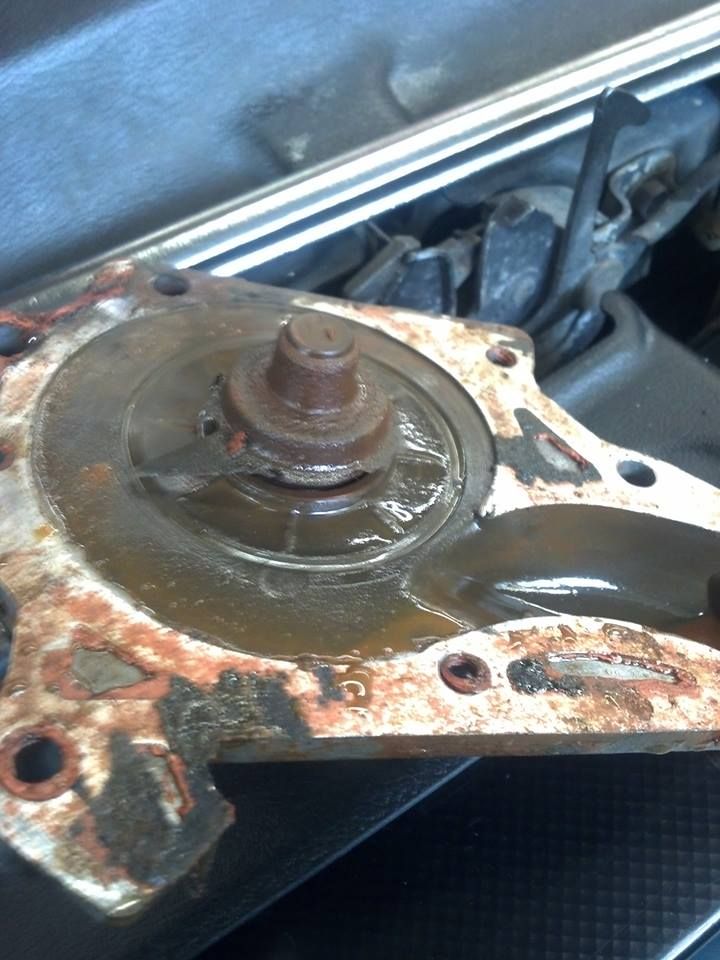

The steam was coming out of the overflow tank. When I was driving home, I am reasonably certain that radiator cap was completely shot. It has a new one now, and I have yet to see any actual steam coming out with it. And its a 0.9bar cap. So when I get it to the shop Monday I'll pressure test, then if it passes, I'll put in the new water pump. If it fails, I'll talk to the guy with the Camry.I don't think so.

If you cooling system is still all together, before I would change your water pump, I would do a pressure hold check on your cooling system. Do it cold and again after the engine has reached normal operating temperature. If the cooling system does not maintain a set pressure, there is a leak in the cooling system, and it could very well be coming from a cracked block or a cracked head.
You should also check your coolant that still remains for exhaust gas. There are test strips available for making this test. If this test comes up positive, you know you have an exhaust leak into the cooling system, which is sufficient evidence of a major problem.
I would do at least the exhaust gas test of the coolant (of course, you need enough coolant to do the test, and you need to have run the engine long enough to create the potential for the exhaust gas to appear in the coolant), likely the coolant pressure check, all before messing with putting a new water pump on the engine. Best to know this first.
